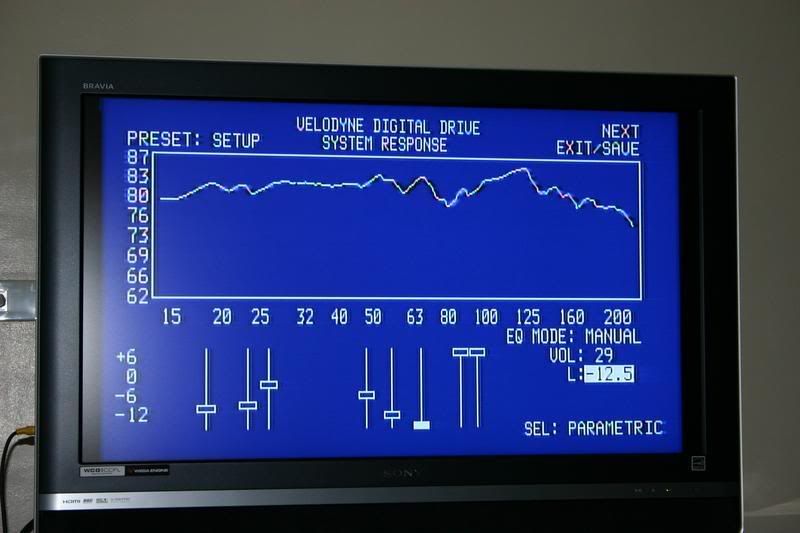

I found the best location in my room due to the room eq wizard :) its easier moving the axiom sub than this DD, the SPL meter has paid for itself already :)
I think the peak increases as I mess with the EQ sliders ... will take a pic of the eq'd thingy (I do have 2 sliders boosting 6db each at 15hz - i dont like seeing that drop to 77.5db :) )
You may want to re-think those 15Hz boosts. They won't buy you much and waste amp power in the process. If I were you I would just try a few movies and music at these baseline settings and then tweak.
mike c
mike c
my dd eq'd without the 15hz boosts

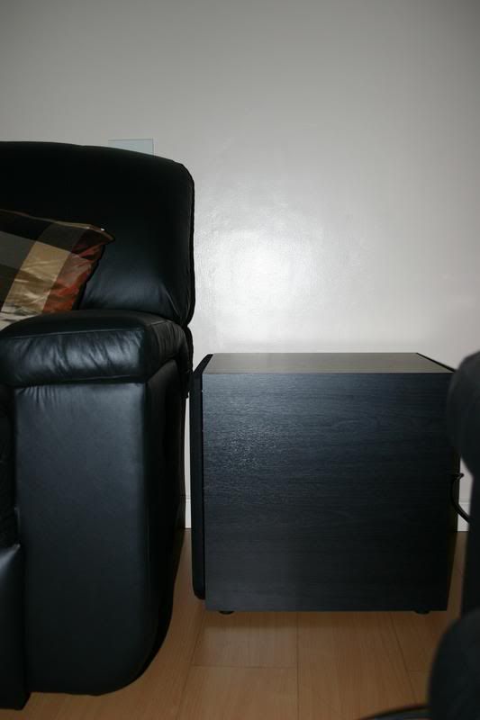

no more need for a buttkicker
the axiom ep500 as a couch shaker
the DD is calibrated to be 2-3db's hotter than the other channels ...
when the axiom is also ON, the sub channel becomes 15-20db hotter

Mike,
Looks like your getting there. The Velo EQ is easy to use, provides instant feedback and it will show you the effect of your other subs. When I had the Fathom F113, I ran the Velo Sweeps with the DD-18 muted and was able to see the house curve of the Fathom pre and post EQ. Very nice.
Is the EP-500 co-located?
mike c
mike c
no, the ep500 is about a seat away from me, the DD is on the same line as the front speakers ... the EQ pic above only shows the DD ... I also muted the DD to measure the EP500 but I already knew the EP500 was pretty linear most anywhere I put it ...
when measured at the same time ... of course, the graph gets messed up (not being co-located and all)
I have two other options for this EP500 in the same position ... speaker level connection instead of LFE for EITHER the fronts or the SURROUNDS

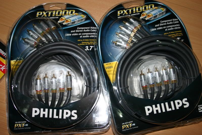

cables (hey, I like the looks of these guys - and I had nothing to buy from costco, so I grabbed these and a maxtor external wireless HD that I don't now know why I bought it)
