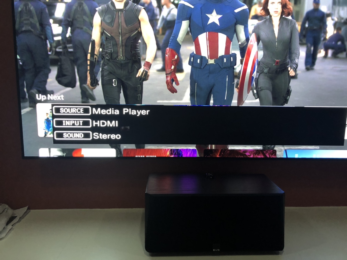

Of course I have another question!
So when I turn on Apple TV and get to the home screen, an on screen display comes on for like 10 seconds. See image. It shows the input and audio etc.
I believe it’s From the Marantz?
Is there a way to avoid this pop up altogether?
Is there a setting under the avr to bypass this pop up message?
Thanks!
I get something like that when I press the info button on my Denon. Might use the setup button on your remote and see what options you have in video/on screen display?
I was just thinking that. It's the info screen when you push the info button.

Ok but I don’t hit info button.
I just power on the Apple TV
Is there a way to bypass ?
Maybe in the ATV? Does any other input source do this?
Thanks!
It's exactly what you see when you depress the Info button on your remote.
I have an SR5010 and it does the same thing. I doubt that you can annul that short display, but it has a positive feature: It tells you what is the Audio Source format and you can see whether or not your Audio Playback setting is compatible with the source.
In any case, that display time is rather short. It doesn't ruin anything.

Ok I feel stupid
Went into avr -
On screen display
Turn info off
