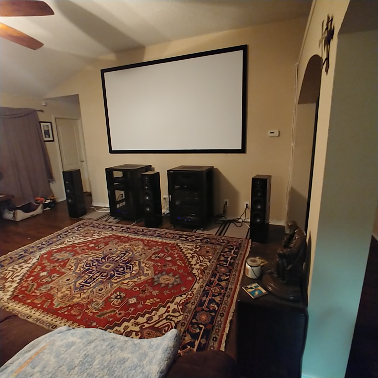

It all depends on the height of the towers. Main speakers don't necessarily have to be towers.
For example, my main speakers are less than 35" tall and they're on casters:

Matching LCRs is the way to go if you can pull it off. My SVS Prime towers almost fit under my TV anyway so I just moved the TV up a few inches.
I really like your rigs. I like when people post real life rigs unlike those brochure ones. I'm not a voyeur, I just like getting ideas from real life situations.
I will say my GF would never go for any of the two. I think we should have more of the "post the pics of your system" threads, ours is fairly slow and empty. Mine is too far from being done for me to show. One more reason why I like to see what you people are doing.

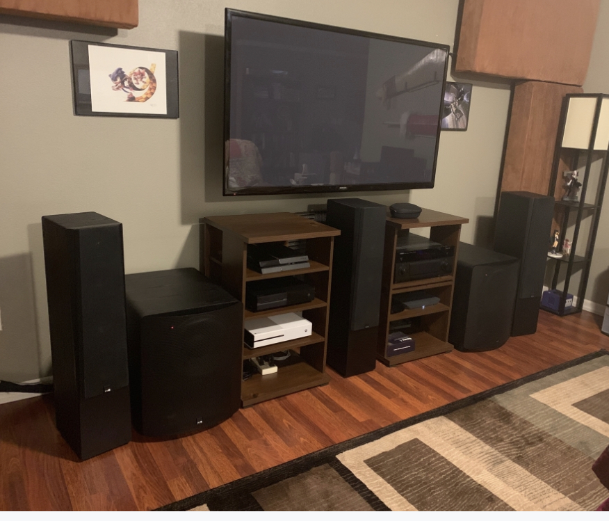

Is it a cost issue or appearance? I’m helping a friend of mine put together a system but he doesn’t want to spend and ton and it can’t take up half the room like mine does. So I sold him me used Marantz SR7008 and he’s going to order some decent bookshelves, a center and satellites. Plus a sealed sub. The book shelves are only like 8”w x 10”t so they don’t look imposing. The sub is a 12” but the cabinet is only a 14” cube. All said and done he’ll probably come out under $2k for the whole thing but it’ll sound great.

Appearance. I could probably talk her into anything, but I'd feel bad. I'm also very much into visual aesthetic, so my guess is she would approve what I'd choose. What bookshelves is he ordering?

He’s ordering the SVS Prime bookshelves. After hearing my systems he’s really taken with those speakers so he wants something similar. My second system has all the same speakers he’s getting for his.
This picture is a bit dark, but you get the idea.

I need to experiment with different sub placements but my room isn’t that big and those subs take up a lot of real estate.
My room is on the big sub and a great spot for my subs was behind the couches in a near field setup
Those are PB 2000's correct? I used to own those and loved them how do you like them?
Yeah. I almost got a pair of the 1000s at the time but my wife actually convinced me to get the bigger ones. “You won’t be disappointed if you get more speaker than you need but you will be if you get less than you expected”
I love them. In the space I have they work really well. They’re only turned up about half way on the sub and about -3 on the AVR. That’s usually enough.
