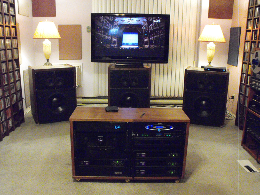

It all depends on the height of the towers. Main speakers don't necessarily have to be towers.
For example, my main speakers are less than 35" tall and they're on casters:View attachment 28225
Hey I've been meaning to tell you I love your setup! And I love how you converted a front table into your equipment rack! Very clever and very slick!
Thank goodness for pro amps eh? Just try cramming some classic AB amps in that spot!
