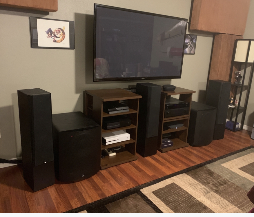

SEF_Makaro, This is exactly as I envision my setup after reading elsewhere on Audioholics about using a sound transparent projector screen. All of this just because we are trying to use the same speaker for left/right/center and a wall mounted TV. 100% what I am about to do. What is the wooden box in the far right corner? And absorption wall treatment above that?
I was wondering for my equipment racks, if it is better to have them wide open for air, or if it's better to have them enclosed with glass fronts so that they prevent dust from getting on the electronics? Need to buy a pair, since I currently have a TV stand I am using. Thanks for sharing your setup.

If you’re asking about the brown things attached to the wall, they’re both absorbers. I have the same setup on the other side of the room so it’s symmetrical. 1x3” wood frames with 4” of rigid fiberglass insulation wrapped in fabric. I got my wife involved in building those by having her pick the fabric.
Open racks is the way I’d go. It won’t protect from dust but it’s better for ventilation. I’d think too much heat would kill electronics faster than a normal amount of dusk would. I had to cut the back out of that rack to fit the A3080 in there, the thing is a beast. I’ve been looking at these, might pick them up when I feel like tearing the system down again.

Agree: open racks for equipment is highly recommended. I would go a step further with something like an AC Infinity T-series cooling unit on top. I recommend the rear venting model so long as you have room behind, at least 8 inches.

I checked out their site, pretty cool stuff. I’ll have to keep that in mind if I go to an enclosed cabinet again.
Edit- Looked again and saw the component cooler you can stack on top of the amp/avr. I’ll be adding that to my shopping list, it’s pretty inexpensive too.

If you are in a closed cabinet, you still need about 6-8 inches on all sides... that's a lot of room! The Front Vent AC Infinity worked well in that scenario... but you can hear the fans... Doesn't bother me that much when I'm listening to music (eco mode on the Marantz+external amp keeps the marantz pretty cool). But rear venting... That's on my list! ;)
