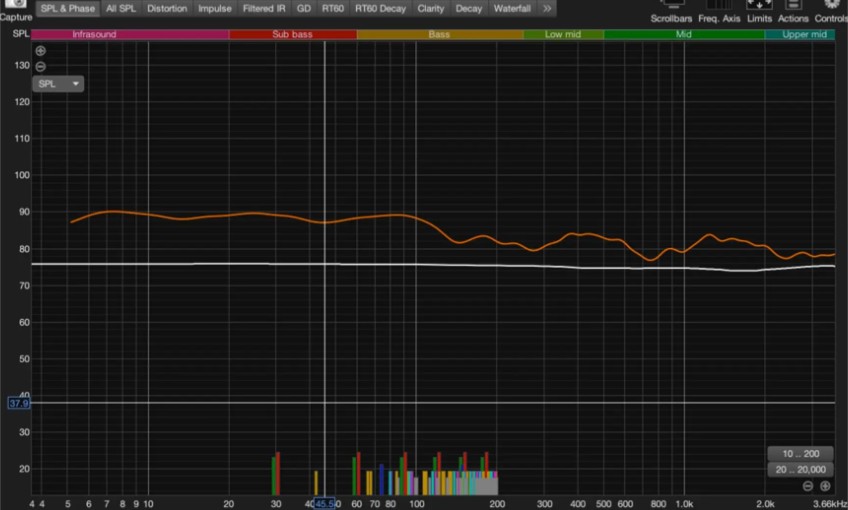

Here is a graph from another forum with an MRX1140 down to 5hz at almost 90 dB with ARC room correction turned off.
You can see he is hitting 5hz with no issues
The one thing I did not ask , is if this is run through a mini DSP to get this graph, so I wil do that.
I think since there are so many different opinions here, I will definitley need to play with things once I get this setup , up and running, and will post my findings back here.
I have yet to learn how to fully use REW, but I see no reason why one couldnt play a 5hz or 10hz tone to verify output to set this whole argument to rest here.
See how bumpy that forum post's curve is, varying up and down by many dB between 20-20khz? Whereas the professional review site I linked to doesn't even vary by a single dB over that same range? This tells us the forum guy used a microphone rather than the proper way (to measure an electrical product) using a direct electrical wire.
When recording the output of a speaker you are sort of forced to use a mic but for an electrical device like a preamp, processor, or AVR you want to use the direct electrical feed only.
Recording with a mic is highly flawed because it introduces tons of huge variables:
- mic distance
- mic centering [Was it in front of the tweeter? The woofer? In between but close to the woofer? etc.]
- mic aiming
- mic flaws and pickup pattern
- mic calibration (if any)
- room reflections contaminating the signal [unless, say, performed in an anechoic chamber]
- "room gain"/cabin pressure/vessel pressure, or whatever it is called these days
- spurious environmental noise [like that low rumble from the garbage truck across the street you weren't even consciously aware of during the measurement because it was below your threshold level of detection, but not that of the mic's]
- was, as you mention, DSP/EQ used?

See how bumpy that forum post's curve is, varying up and down by many dB between 20-20khz? Whereas the professional review site I linked to doesn't even vary by a single dB over that same range? This tells us the forum guy used a microphone rather than the proper way using a direct electrical wire.
When recording the output of a speaker you are sort of forced to use a mic but for an electrical device like a preamp, processor, or AVR you want to use the direct electrical feed.
- mic distance
- mic aiming
I do see how bumpy the curve is.
I believe he was doing Room correction though, so you would want a microphone as opposed to a direct wire otherwise, how would you be able to see how the room reacts?
I have asked the question on the other forum, if a mini dsp was used. I will report back if I get an answer
