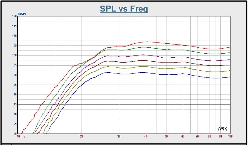

For comparison here is what I think is optimal for the lower octave reproduction. Unfortunately, it requires a tolerant wife and a lot of experience to design it.
These are my full range dual lines.
I made these measurements as loud as I could stand it. Note the frequency response is smooth and roll of is indeed second order, as the pipes are damped just to the point where there is one peak of impedance. There is slight 5db ripple where the pipes transition. The measurements are taken just below 100 db. These are truly full range speakers.
It is a myth that pipes have high distortion. When calculating db to % THD, the maximum bass distortion at that power is 2% THD.
It is also a myth that pipes have poor impulse characteristics. While this shows a little over hang the result is superior.
At least for me, and I've been designing pipes for 60 years now, this is the most ideal bass loading I know. Unfortunately it is up against practicalities.
It should be noted that these pipes are doing this with standard audio drivers, not sub drivers. One speaker was used containing two 10" SEAS Excel metal coned drivers.
