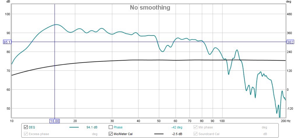

I hear that! I used to use a BFD for a long time until I got a minidsp. FWIW, the bfd is very effective but it’s a lot more archaic than the minidsp.
Btw, can’t remember who said not to run 3 subs(which I’ve heard counter to), but it definitely works for me.
I’ll fix that 50hz range soon.

Even, Odd... the more the LF sources you have, the better.
...Ya buddy... what's up with that dip... looks deep enough for 7-layers at the superbowl party! :oops::p:cool:
Sexy curve otherwise! :D

Thanks brother. I do luuv me some 7 layer dip too!arriba!!!
It’s deep enough to spend time fixing, but it’s not super horrible with content. I guess...
O. C. D. Is. Killing. ME!
I’ll get it soon.
I’ll get it soon.
Sorry man... just couldn't pass it up. Cheers!
