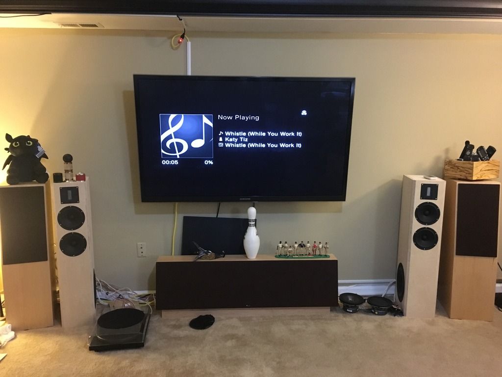

Go the speakers set up. Wasn't sure how it would work with two pairs of speakers, one with side firing PR's and the other with side firing woofers in an AB AB configuration so went with what's below. Sounds fine to me. I just need to rerun Audyssey for the outside (HT) speakers. Also below is 1/2 component racks. The Threshold is now driving the Testarossas and the antimode is in that signal chain providing level matching and bass management.
TheWarrior
TheWarrior
All this excitement and anticipation, and ,"sounds fine to me" ???????
