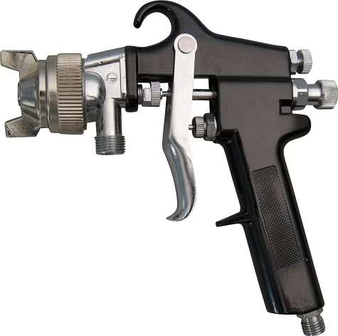

Nice! Haven't tried a HVLP sprayer before. What do you think works better - a compressor attachment type, or a self-contained electric model? I have a compressor, so either would be an option. I imagine it would require some in-line air filtration for moisture and/or contaminants?
I'm not thinking of diving whole hog into spray finishing, but I'll probably be retiring next year and will be doing more woodwork projects. So, branching out a bit may be fun.
I have only used a separate compressor. Yes, filtration and moisture removal is the most important. Can practice spray pattern and output settings with water to get the feel of things. Weather also plays an important part. I won't spray outdoors here until the fall and winter when humidity levels drop. Otherwise, I have to use retarder and still choose my better days.

I have a spray gun for my compressor but I'm not sure if it's suitable for wood finishes. I've only used it for exterior paint jobs. I should post a photo and get some opinions.

I have a cheap HVLP off the scamazon. It was able to do instrument lacquer pretty flawlessly on the Continuums.

I have a Power Fist spray gun and the 10 litre spray tank. SKU 8006583 on the Princees Auto website. It's designed for heavier liquids like latex paints. Worked great for painting the garage and shed. I don't think I can get a fine enough spray for wood finishes. Probably best to get a new HVLP sprayer like you have.
Look to see if they offer different tips for different paints.
Can't find any other tips offered for this model. They advertise it as best used for big jobs as it's designed to pair with the 10 litre tank to draw paint from. That makes it best used with water soluble paints as I need to clean out the hoses each time. Not too bad a job as you only need to run water through the system until it's clear. I haven't used it in a while so I would have to experiment with how wide the spray pattern is and how fine the droplets are.
The gun I have is on about the same quality as those found at Harbor Freight and other discount outlet stores and I think I may have $40 in it and it sprays well.
