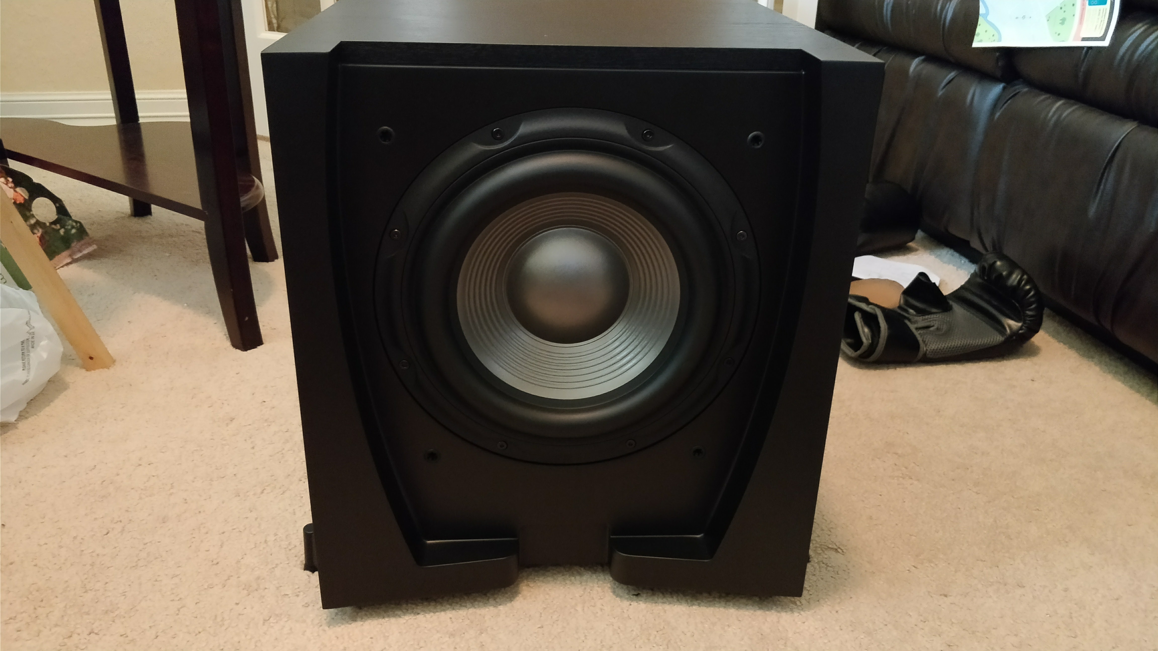

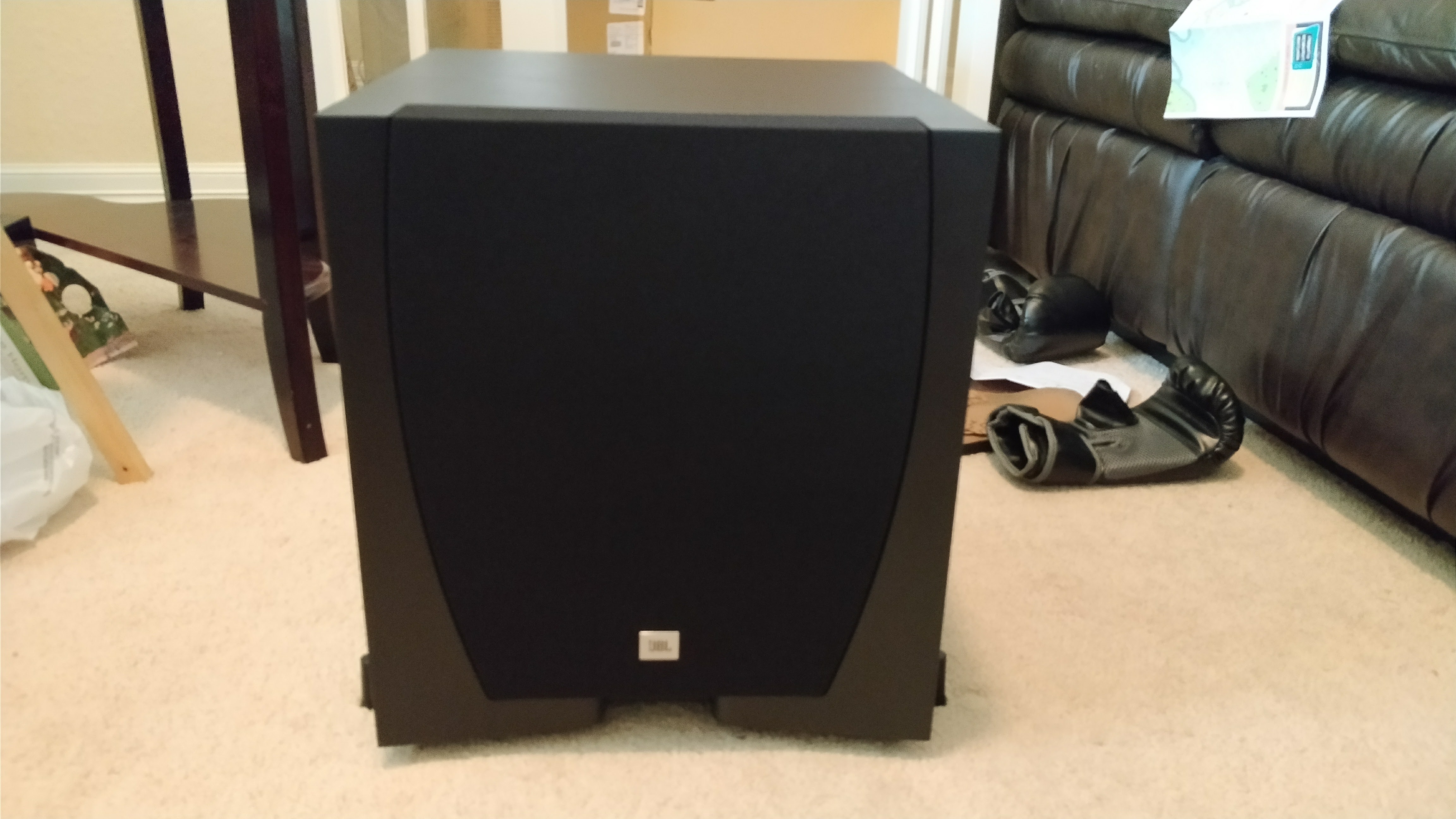

So, I got one of these JBL Studio 550P 10-Inch Subwoofers from Amazon for $189. MSRP $599.
One of the main questions all of us had was "why does this thing weigh 50lbs?" Well, I know why.
One thing I can say is that it's pretty minimalist which I like. Won't draw attention to itself in my office.

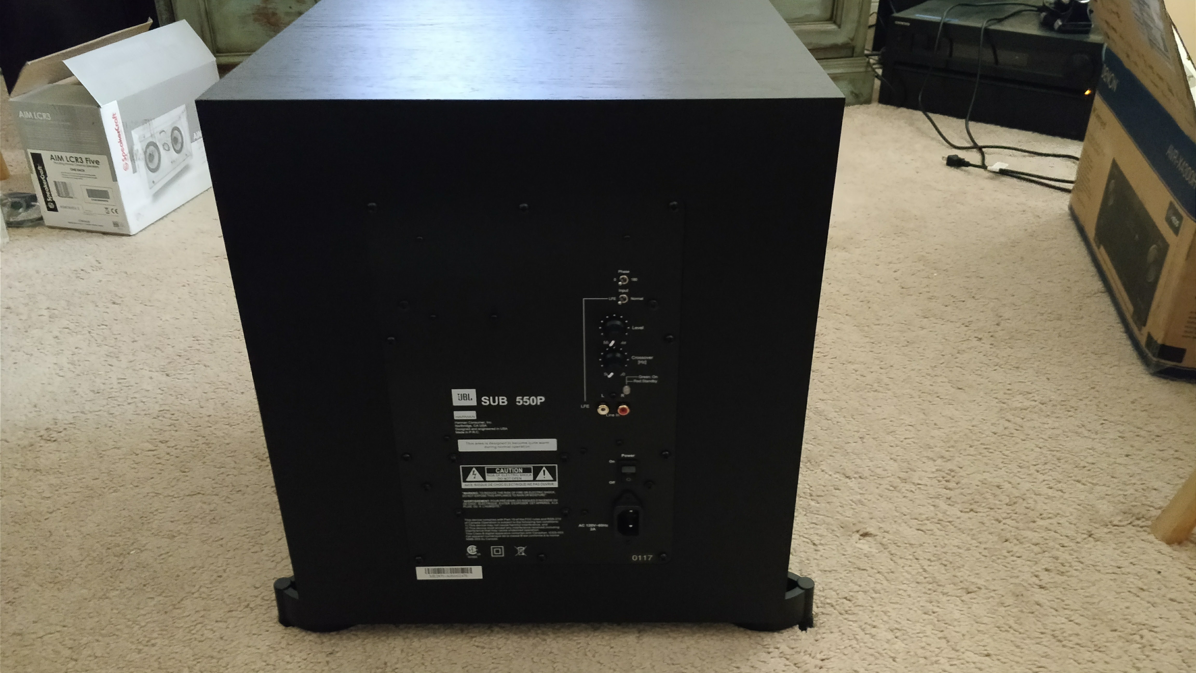

Back is strait forward enough.
Driver looks small compared to the box. Pretty large box for a sealed 10" sub.

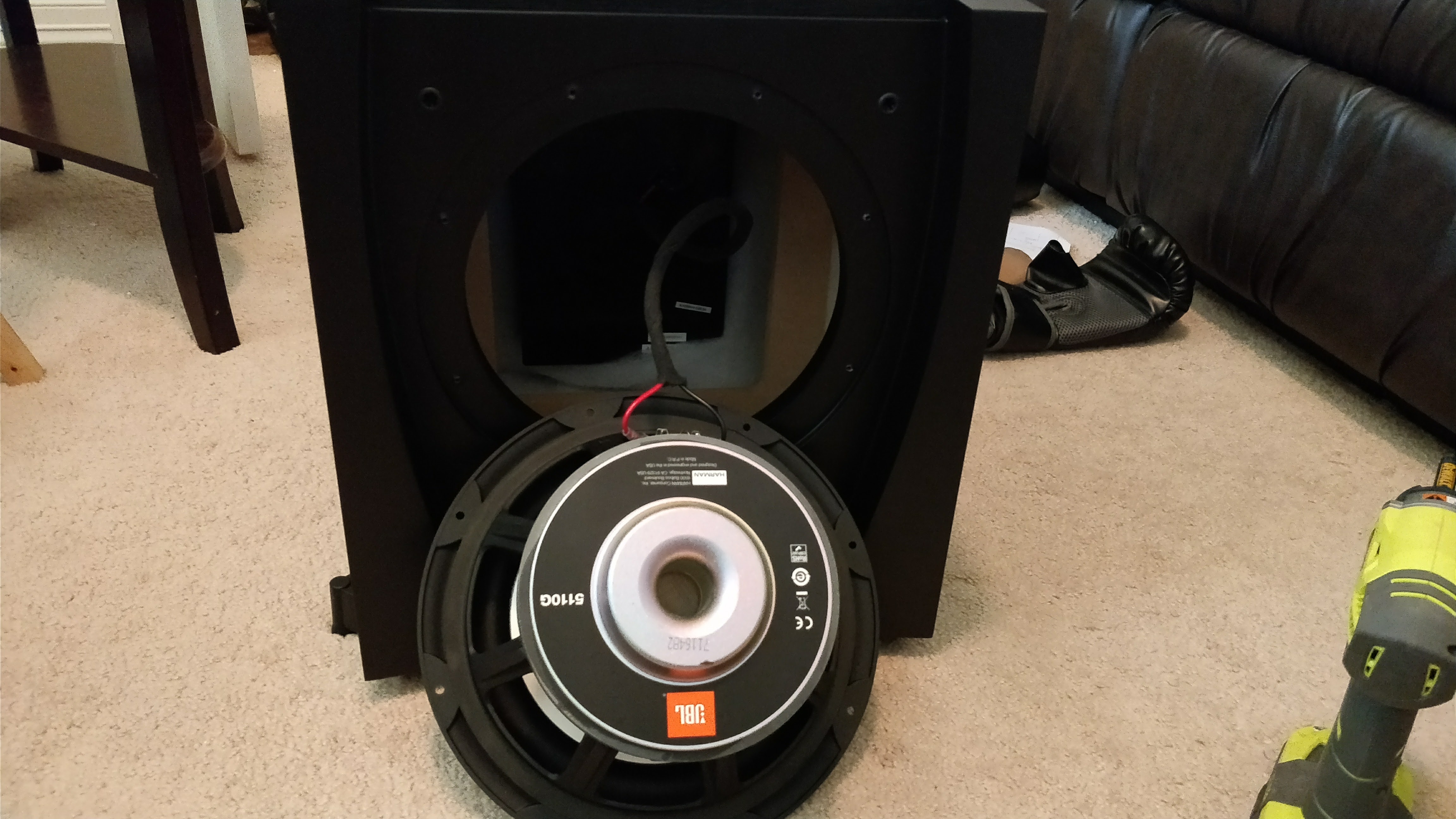

Removed the driver and it's not small. Easily 1/3 the weight of the unit.

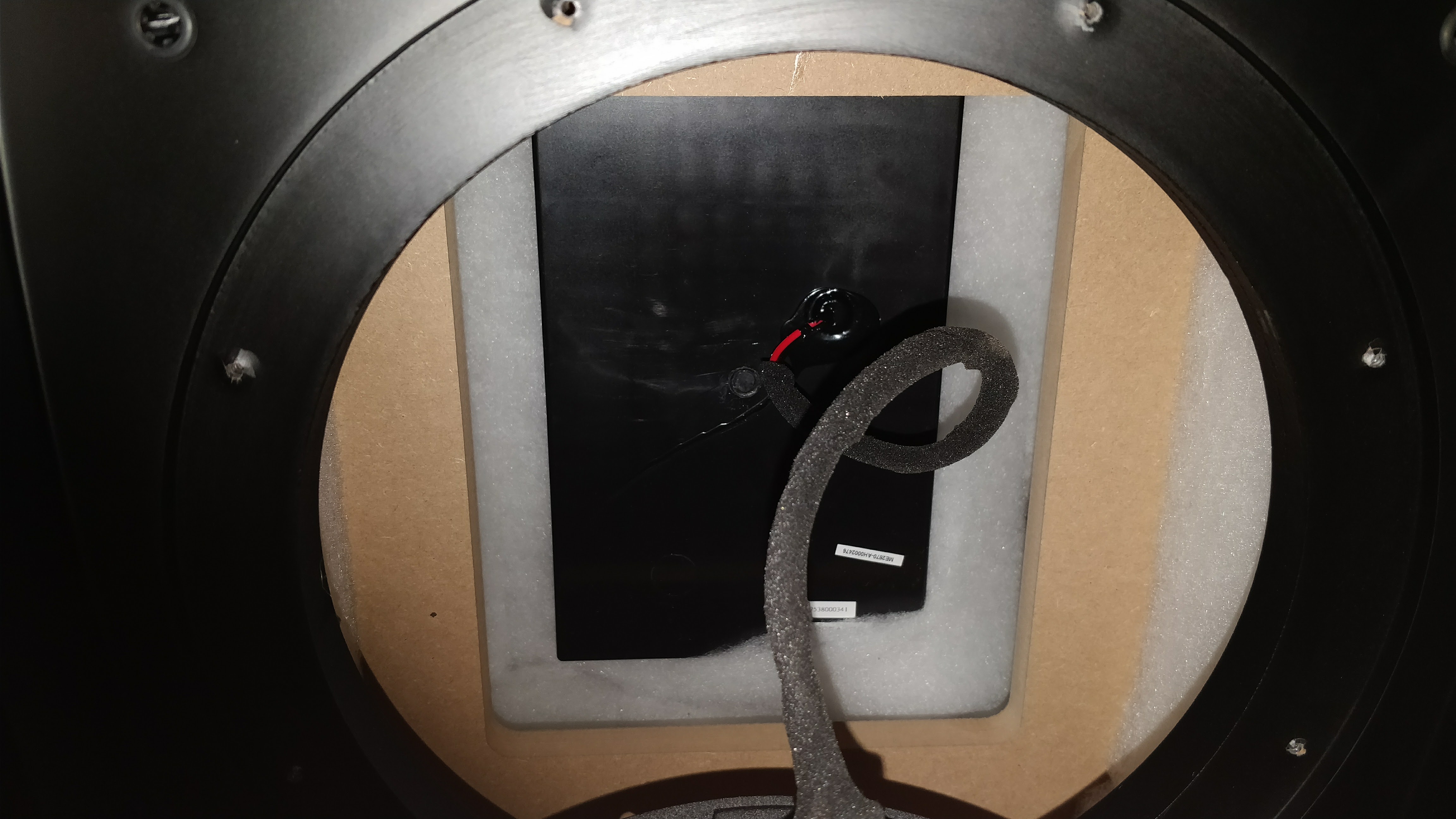

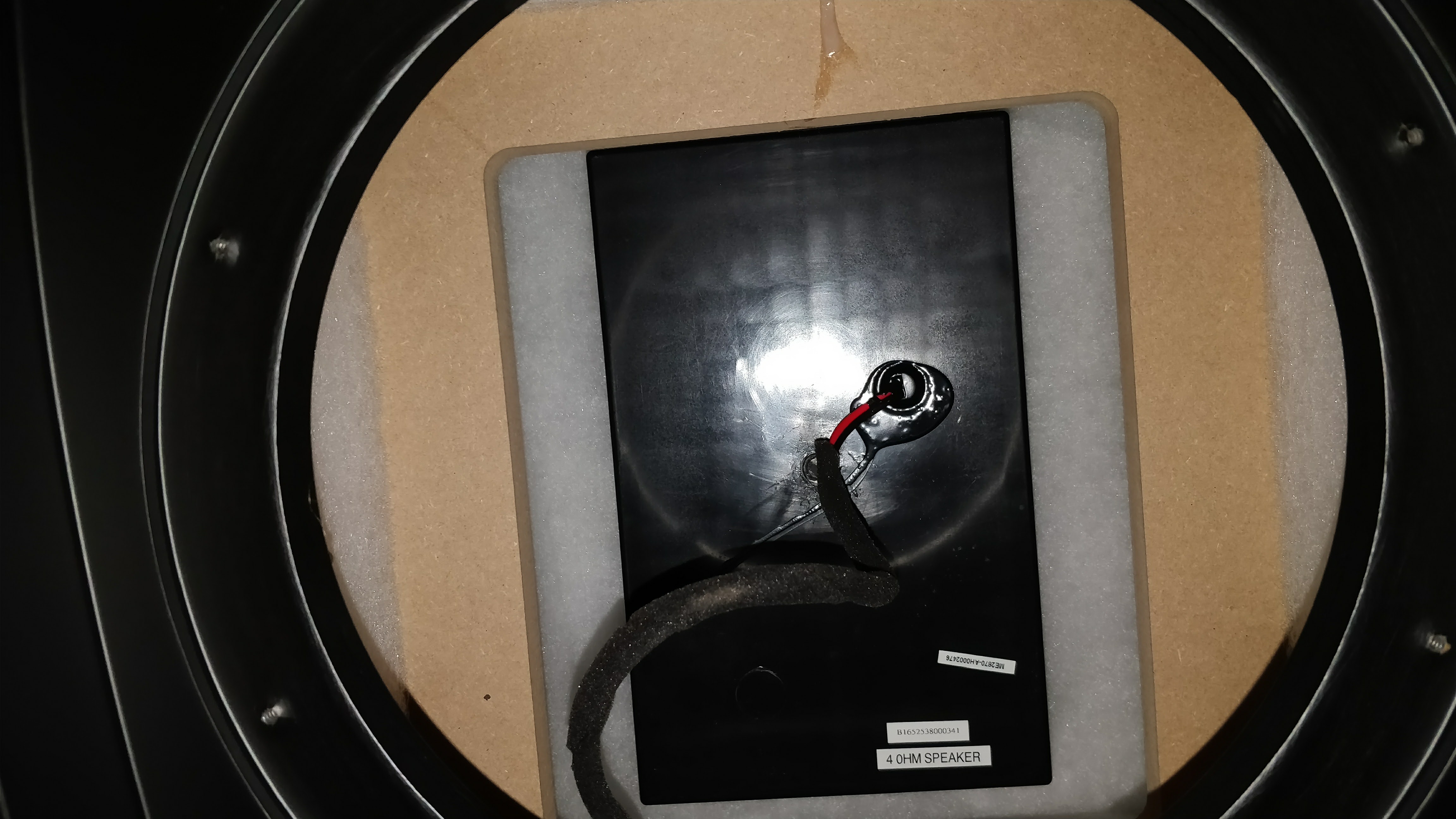

A few interior shots of the box and bracing. Decent amount of foam, but the thing that's hard to see is that this is 1" MDF all around. Very easily 1/3 weight of the unit with the amp making up the last 1/3.

Thanks for the info...especially explaining where the weight is!
Nice to see such a solid looking driver! From the outside, those drivers don't look like much compared to many other companies who invest more in the external appearance and less in the function.
The rings in the drivers remind me of the 12" full range speaker my dad had in his monophonic Heathkit Hi-Fi system, lol! But this one has a lot more magnet than those did!

Anyone notice that the 550P also has speaker inputs on their site?
https://www.jbl.com/studio-5-series/SUB+550P.html
I wonder why they switched it to just RCA, or if maybe they are selling 2 versions.

I suspect that somewhere along the way, JBL accidentally mixed up their plate amp photos. I do not believe the 550p has speaker level inputs. If you look at the Amazon listing, you will see the speaker level inputs. Currently there are eight 5-star reviews and two 2-star (or 1-star?) reviews. The 2 "negative" reviews are by people who bought this sub with the expectation/need for speaker level inputs!
Like you, I am disappointed that JBL didn't "grab the bull by the horns" and start producing high performance subwoofers. However, my expectations for a 10" sealed sub are a good woofer to fill out the low frequencies for music, and that falls squarely within JBL's competencies! Anyone looking for LFE should look elsewhere.

Amazon reviews aren't all that model number accurate IME....Amazon invited me to answer questions on the 580 before I even bought them....and generally their reviews often mix model numbers among similar models IME.

I think part number solves this little mystery:
P/N 353590 - 001 as in:
Detail:
  • JBL Inc. Speaker Subwoofer
  • Studio L Series
  • Model L8400P
  • Color: Black
  • S/N 00A0253-01145
  • PN. 353590-001
  • 12" subwoofer
  • 600-watt amplifier
  • 120v - 60Hz
  • Measures approx. 16 1/2" x 16 1/4" x 15 1/4"
That picture you linked belongs to a stronger model.
