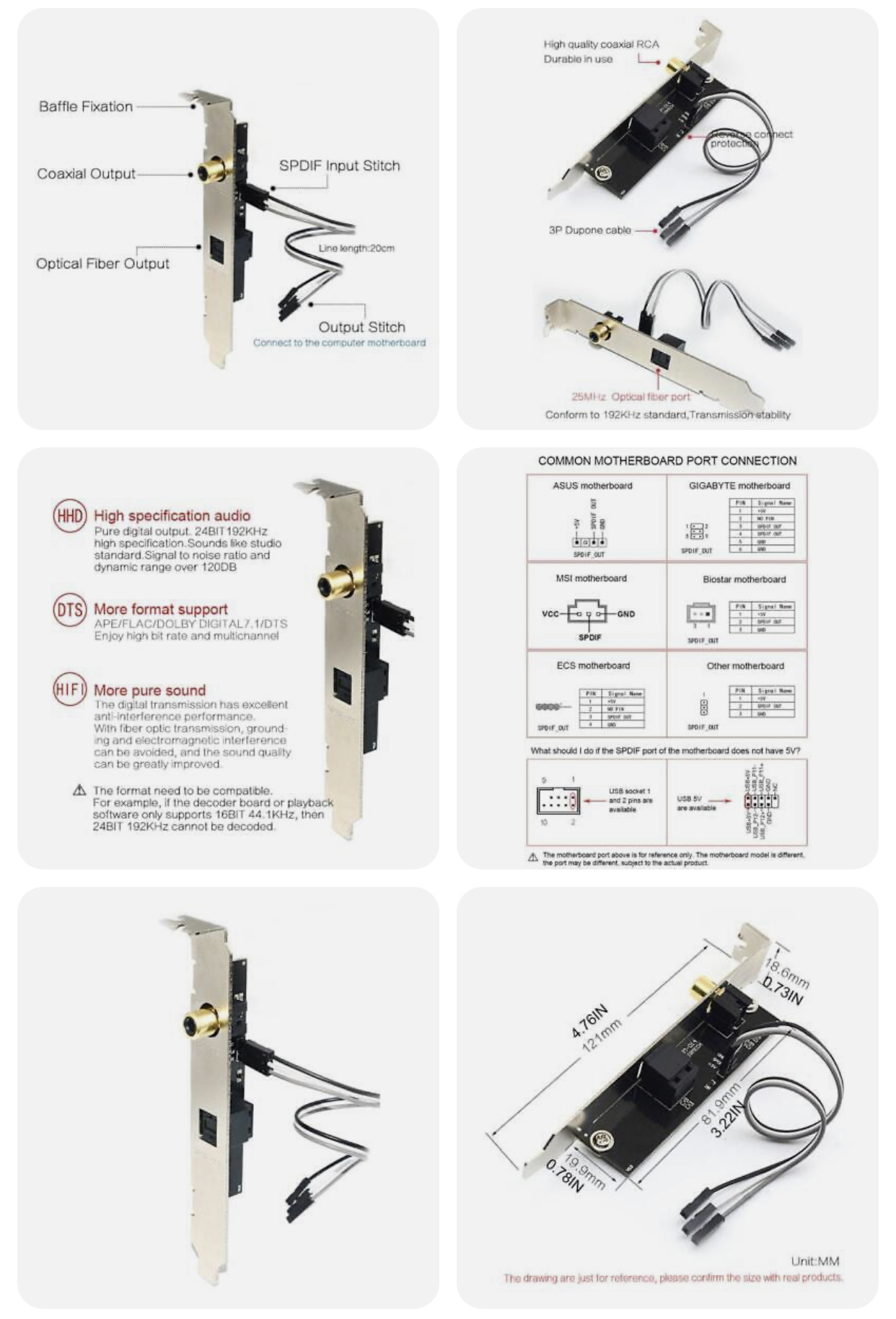

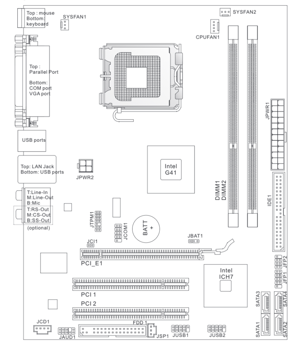

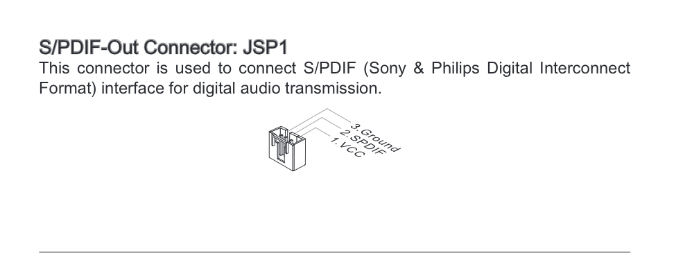

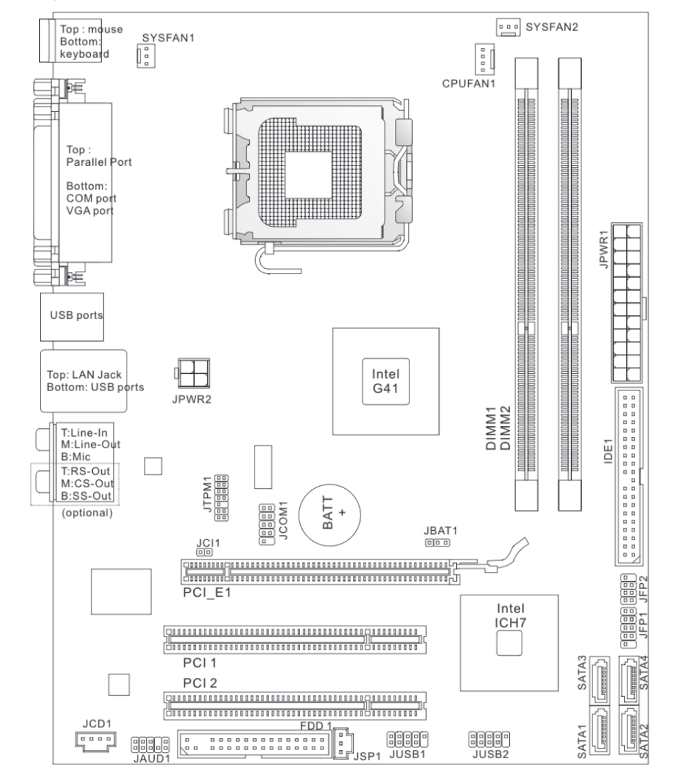

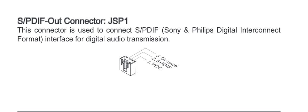

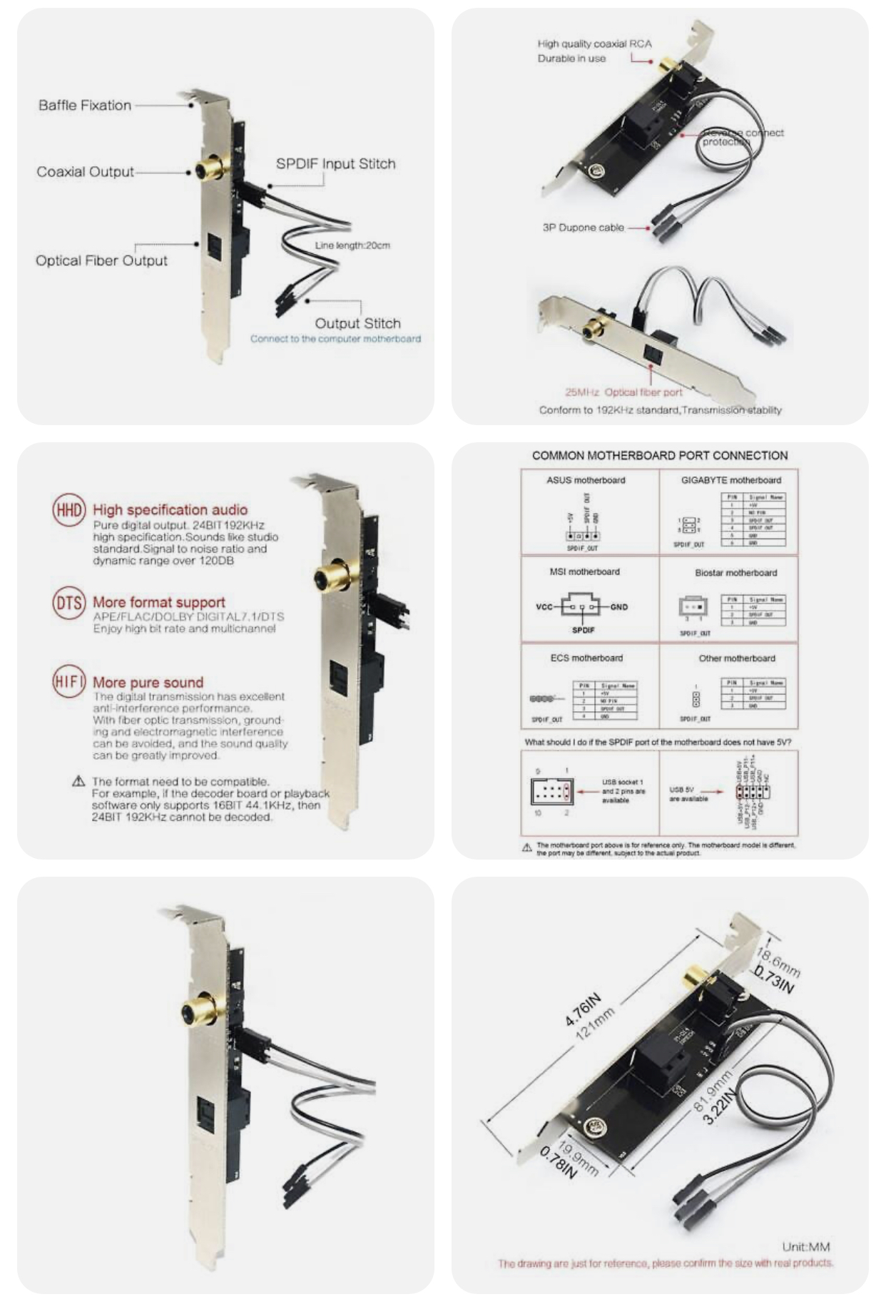

Using the EXT. IN analog ports on the Denon does limit things to same in, same out with no audio processing at all. Have you looked into adding an S/PDIF port to the PC for digital output to the Denon so you can use bass management for two channel signals?
The cables for the new port would connect to your motherboard’s JSP1 connector. Then, you can bitstream digital audio and benefit from the Denon’s processing of digital signals and will only need the SW PRE OUT to the subwoofer of your choice.
Dynatuber
Dynatuber
View attachment 61246View attachment 61249View attachment 61247
Wow. Thanks for looking up all that for me @Trebdp83. I did in fact get one of those small S/PDIF cards for the MSI a number of years back. But try as I might, I was never able to get it working. That was suggested over on the AVS forums the other day so I've been trying to find where I put it. I can't remember what the issues were, drivers maybe. But since then I've set up optical cables a couple times between my HDTV & STB to the Denon. I'll have another go at that S/PDIF card if I can track it down. You nailed my MB and the jumper locations. Maybe I'll order another if I can locate my old one and still can't get it working. They're only $10 - $15.
