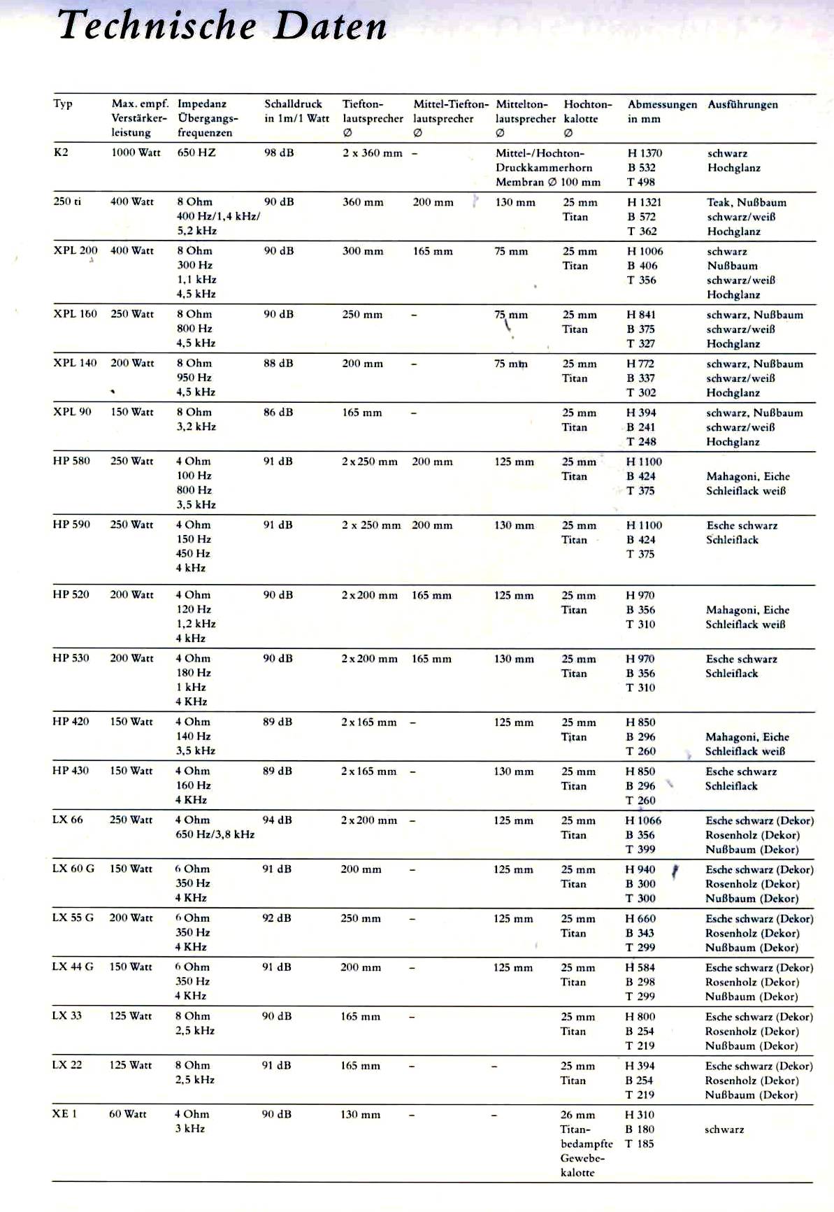

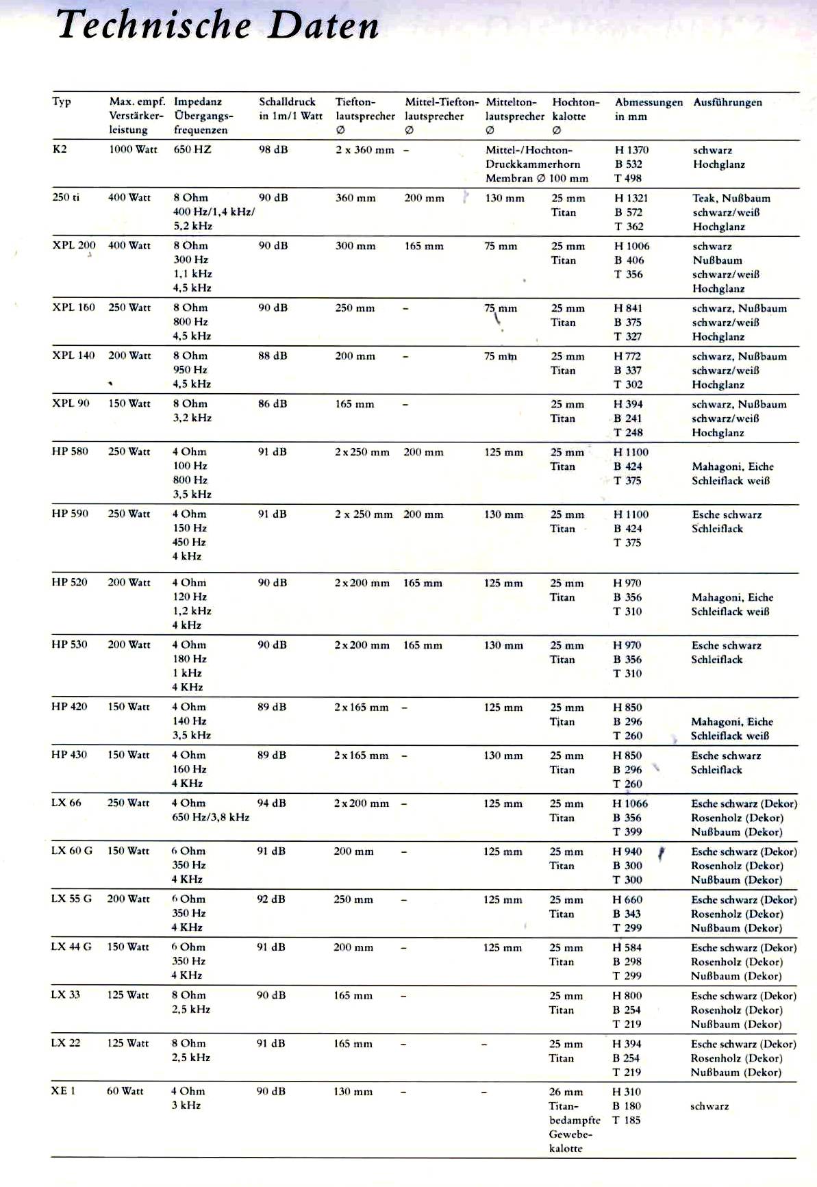

Inner diameter without the wooden frame is about 180mm.
But in the advertisement from around 1990 it is advertised as two 200mm woofers.
I’ve never seen this version before is that saying 18 inch across?
Mark E. Long
Mark E. Long
These appear to be from the European market as well as I’ve seen this design but the but the woofers was not mounted to a chamber and not in the top this a new one on me . Interesting how do these sound ?
HaGii
It’s 18 centimetres. Even though it says 20 centimetres on the original data sheet.
See here:
