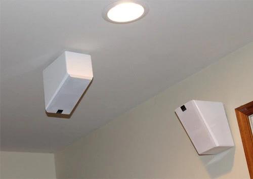

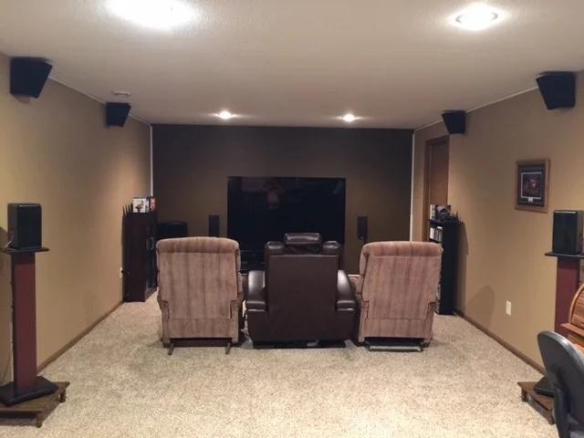

Now...the rear surrounds...looking at the performa3 S206's...$900ea...seems like a really good surround speaker...thoughts?
And...the height speakers...I know Revel does "in ceiling" speakers...Is this the route to go to get Atmos? They carry a bunch of options for in ceiling but don't see much that could be mounted on the ceiling pointed down (like my bose cube speakers are now)...I didn't really want to have to cut out a hole in the ceiling to mount these but I will if that's the best option
William Lemmerhirt
William Lemmerhirt
If you’re really interested in not cutting up the ceiling, SVS prime elevation offers good options.
shadyJ
Speaker of the House
Staff member
Okay so here is where I am at with a potential setup
2 x Performa3 208 = $5,000
1 x Performa3 C208 = $2,000
1 x PB-3000 = $1,500
Sub-Total = $8,500 + Tax
Looks like a great setup. As was pointed out, SVS has Ellevation speakers which can be mounted with should approximate the height channels very well, so you don't have to cut holes in the ceiling.
