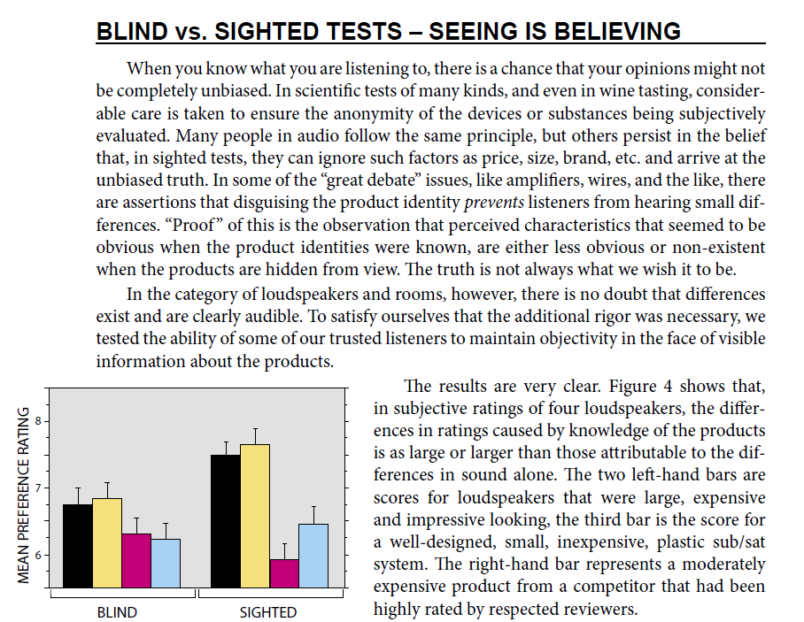

2. Bias. No one is immune to bias. Everyone has a different opinion, which contributes to your overwhelmed feeling. All measurements of all speakers and electronics are a good guideline, but they are definitely not the end to all. So look at measurements, but also use your ears, eyes, and your brain.

That is absolutely a good idea before you finalize your choice, if you do that, the remaining uncertainty would be "bias". As a well regarded expert wrote in one of his many articles/books:
It would be great if somehow you can do a blind test in the dealer's place. I had tried that a couple times in the past and it was extremely difficult to do but I did get some benefit from it.
Not to digress too much, but the implications that this sort of research has for high-end audio can not be over-stated. If you ask me, it is the elephant in the room, and if people actually understood what it meant, it would smash everything to pieces. What it is saying, as well as many other studies like it, is that we hear with our eyes and not our ears when we are looking at what we are listening to. We also hear with our biases and expectations. The entire hobby of "hi-fi audio" is built on a foundation of sand, and the only reason why it doesn't collapse altogether is that human beings are fundamentally emotional and not rational.
