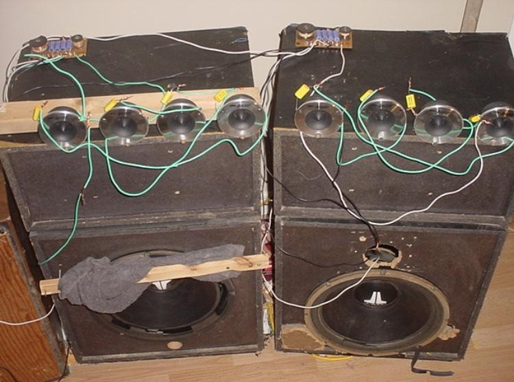

CajunLB
CajunLB
I love that this image continues to pop up in threads, ha ha!
That would make an entertaining new thread.
What are the most “Southern Engineered” speakers you can find with pictures and comments.
