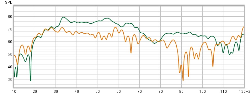

I didn't even know it was a button. Would have been obvious if there were a down arrow next to the box indicating there were other options. Anyway. I swapped out the Klipsch and put the SB1000 in its place, ran a few more sweeps, and applied some filters. Then ran Audyssey. This is what I ended up with (this is with the front speakers reconnected). Not sure why I'm getting the huge dip near 90Hz. This happens to be where Audyssey set the xover for the front channel. I set the xover for the fronts to 80Hz, then 60Hz, then 40Hz, and the dip followed. Does it make sense to make the DSP filters overlap the crossover point to ensure the best transition between subs and mains, or would Audyssey just raise the xover point accordingly?
No smoothing on this curve, by the way.

That is not a terrible looking chart at all.
I was surprised too. But what's up with the dip around 80Hz? It only popped up once I turned the mains back on, so evidently there is some cancellation?
First thoughts would be placement and/or room mode creating that null. You should test your mains out on their own too, and see what you are working with.
If its a placement issue with the Sub, moving it even by an inch could possibly fix it.
Play with sub placement even though the sub's response alone did not show the dip?
I did notice an improvement with the sub response when I moved it a few more inches away from the wall and also when I moved it onto the brick hearth of the fireplace rather than the carpet. I also had a dip around 80Hz or so before applying EQ, but as you can see the dip resurfaced when I connected the mains.
Two parts as I suggested. :) Measure mains by themselves. if the dip is there then you know it's them. If its not, then its an interaction between the Mains and Sub. Tracking it can be frustrating.
One of my towers had a 20dB suckout. I was trying to figure out why it had the null and my other did not. I was in conversation with somebody when I got the idea to look at the wavelength for that frequency. As I was coming to the realization that it was a cancellation due to that frequency wavelength bouncing off the back wall, he was hitting me up with a comment about Wilson Audio always having their display speakers slightly off kilter. I changed that Left Main by about 1.5" from the front and slightly changed the toe angle and the suckout disappeared, becoming a standard LF dip. ;)

I have to admit I'm getting my curves confused now. I will be more methodical once I connect my new subs. This is the response I am currently getting for the SB1000+Mains crossed over at 90Hz with miniDSP and Audyssey EQ:
Audyssey put the xover at 90Hz and I changed it to 80Hz before taking the original curve. Now it is better when crossed over at 90Hz.

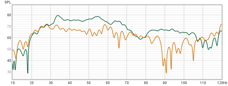

Dip goes away when playing the mains only, and no dip with sub only. Dip resurfaces with sub+mains. I'm not sure what I did, but I can't replicate the huge dip. Oh well, at least it's gone now! :D
To be clear, the green curve is the mains only and brown is sub+mains crossed over at 80Hz. Switching to 90Hz helped, and adjusting sub distance didn't do much.

After obtaining a satisfactory response with the subs only, does it make sense to then connect the mains and allow the DSP to correct the response above the xover point (100Hz for example) to help correct any issues around the xover point you expect to set (e.g. 80Hz)? Sorry if that's confusing. In other words correct the sub+mains response from 20Hz to 100Hz and program the miniDSP, then set the xover on the AVR to 80Hz.
