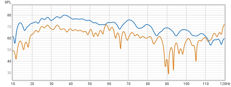

Just wanted to check in quickly. I connected one of the VTF-2 MK5s just now and ran a quick measurement using the filters from the SB-1000 (just to get an idea of what to expect). This is only one sub in the living room, same location as where the SB-1000 was. Looking very promising!
So blue is what, after? Looks very good already tho!

The blue is simply swapping the SB1000 out with one VTF-2 MK5 (using SB1000 filters). Just wanted to quickly see what it would look like. I'll do things properly this weekend.
To clarify, both curves are sub+main response.
Well you're looking pretty damned good already! I can't wait to see what you think when you get both setup and dialed in.
