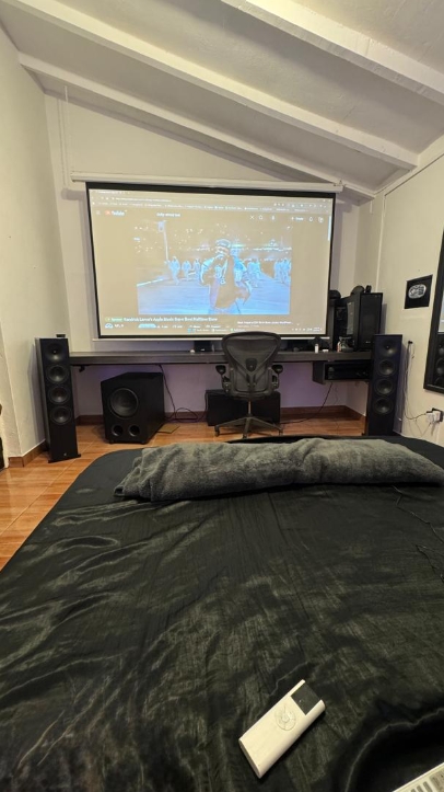

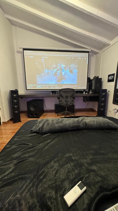

Here:
Is it normal that I don't notice that much difference between pure direct on and off? I know having it on uses the sub because I can see it moving, and having it off doesn't move the subwoofer but honestly I don't notice that much difference when the sub is playing.
Could depennd on how you setup any processing outside of direct mode. Or even just content of what you're playing. You see the cone moving on the sub from where that photo was taken? At what volume?

Yes the cone moves, I tried music, parts of a movie and youtube THX / Dolby tests I'm only using pure direct mode, disabling pure direct doesn't make the sub cone move, I tried all range of volume

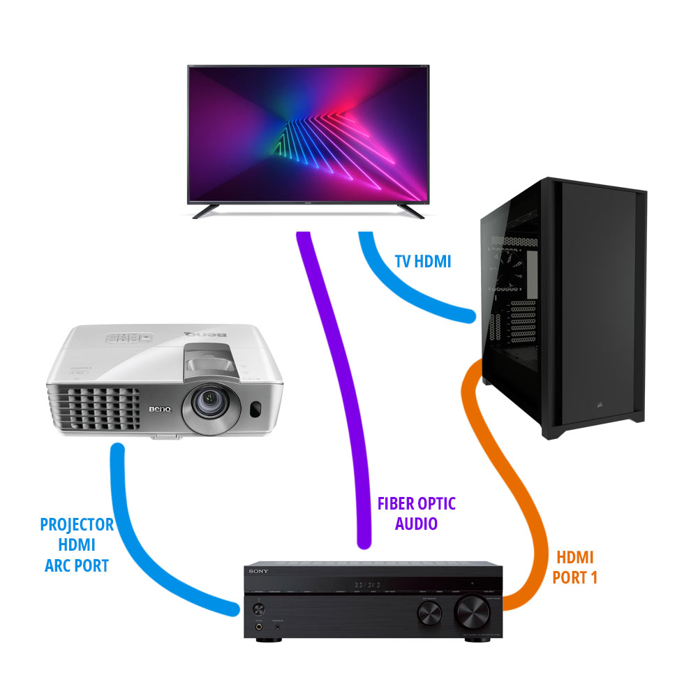

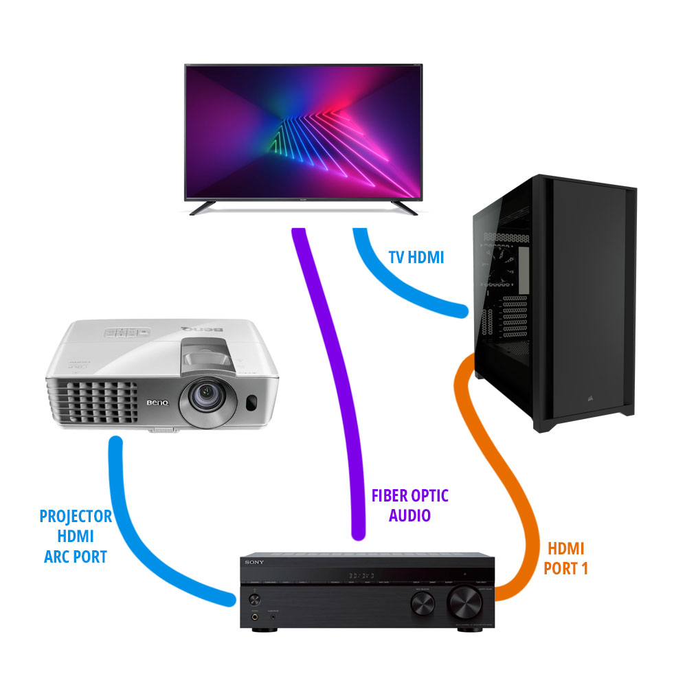

This is how it's connected:

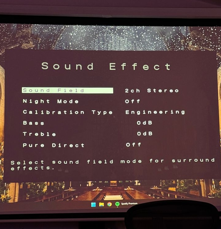

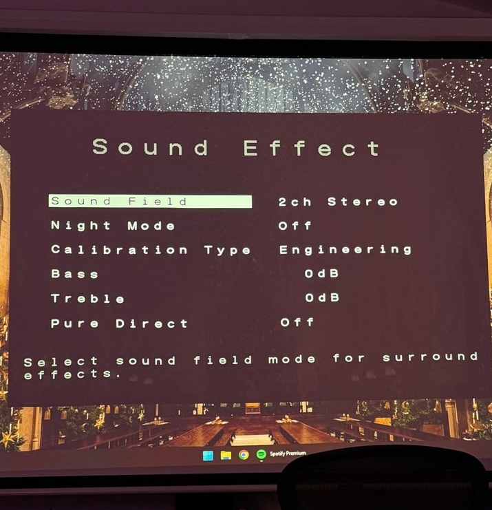

Configuration on the receiver is:
2 CH ST.

Let me see if I understand this...you are using both HDMI's out of the PC. One to a tv set (model unknown), and one to the AVR.
Then, from the tv set, an optical for audio to the AVR.
What's crucial in this arrangement is that the Nvidia Control Program would need to be set to stereo 2 channel and the tv set would need to be set to PCM to avoid any conflicts if you are just using 2 channel stereo on the AVR.
In theory, it shouldn't matter what the Nvidia was set to...but in the likely case that these components are signal fighting each other it just might.
