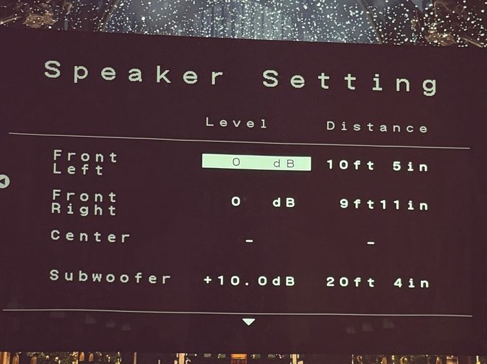

In your picture if the settings I quoted the subwoofer is set up as 20+ ft away. The FL and FR are about 9-10 ft approximately.
This means your receiver is adding delay to the FL and FR speakers equivalent to the time it takes sound to travel the difference of about 10 ft in order for the sound from all the speakers to arrive at your ears at the same moment in time.
When the difference is set up but doesn't exist in reality, the output from FL and FR will still be delayed, but since there's no difference in distance in reality, the sound will not arrive at your ears at the same moment in time.
This offset could cause some cancellations at certain frequencies although I haven't checked if it's in frequencies relevant to what you're experiencing. Thus the suggestion to simply fix the wrong settings since you'll benefit regardless. :)

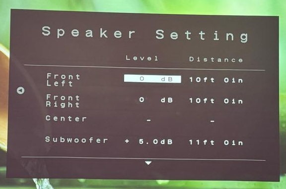

I manually corrected the values and lowered the Subwoofer dB to +5.0 many of you mentioned +10 was too much, but the subwoofer power lowered considerbly and the gain knob its at 12 O'Clock
The sound is lower because you lowered from 10 to 5 dB. Its fine.

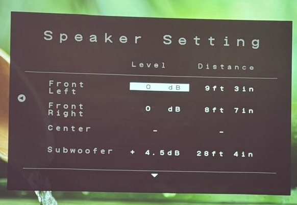

The Y splitter arrived, I re-ran the mic test with the gain knob at 12 o'clock, here the results:
Before:
After:
