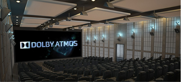

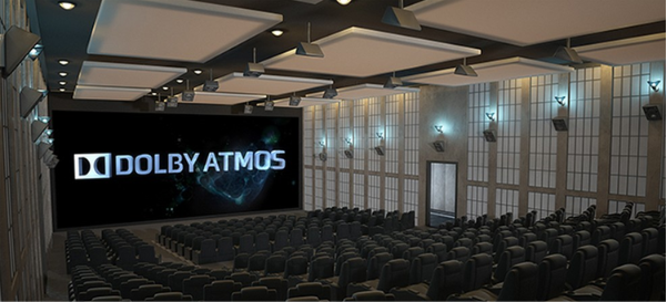

This is meant more as a poll. Can up firing Atmos speakers improve a home theater setup?
Commercial movie houses have already voted in this poll: "They don't really work well so we'd never use them". Atmos theaters always use speakers on the ceiling, even though they take considerable time/effort/money for them to install (and arguably they look weird):
The "upfiring-bounce-off-the-ceiling/+processing" gimmick "technology" was added at the last minute for the consumer market to make the whole thing more palatable for people like me (unwilling/able to mount such speakers) and to appease dealers who foresaw it was otherwise going to be hard to sell.

Commercial movie house have voted: They don't work so they are never used. Atmos theaters always use speakers on the ceiling, even though they take considerable time/effort/money for them to install:
The "upfiring-bounce-off-the-ceiling" gimmick "technology" was added at the last minute for the consumer market to make the whole thing more palatable for people like me (unwilling/able to mount such speakers) and to appease dealers who saw in advance it was otherwise going to be hard to sell.
