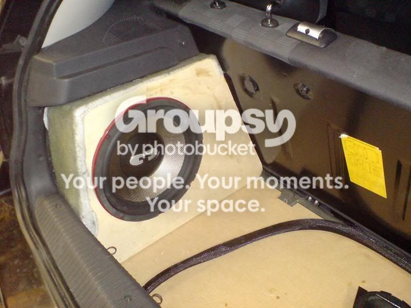

You will only see a small orange ring. Here is a mounted pic I found.
