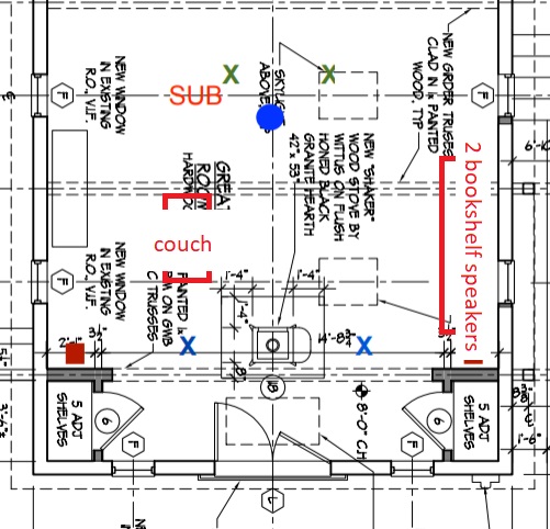

Floor plan and pics are attached. You can see the missions hung on the wall in the kitchen and living room sections. One pic has me pointing at the credenza which seems to be a possible location for some kind of speakers.

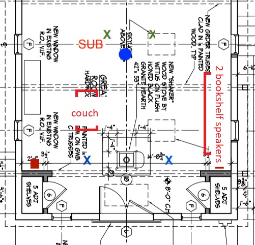

Dudeeeeeeeeee, your choice of speaker placement FOR MUSIC is awful. This is like the layout for speakers in a coffee shop, for christs sakes!!!
Check attached image....can you put 2 lil bookshelf speakers on dedicated stands in the marked area against the wall? (it's tucked away a bit from acrobatic dog and nerf gun shootin kids perhaps). You could sit on the couch (marked area) and face the speakers. If you can set up a pair of bookshelf speakers about 7 or 8 ft apart in that area, that could work out.
If you can do that, you can get yourself a pair of small Technics SB-C700 bookshelf speakers and set them on stands. They are very easy on the eye and could you fit your room's decor. Even my speaker hating Mrs thinks these are mighty cute. But, above all, these are phenomenonal sounding highly resolving speakers with the spookiest holographic imaging you could get at prices like this...And they sound uuggee for their size. If you are a music afficionado, they may treat you really well.
https://hifiheaven.net/shop/Technics-SB-C700-Bookshelf-Speakers-Open-Box?search=technics sb-c700
