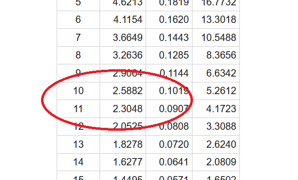

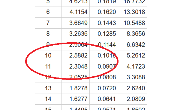

@cafez Well, the one you linked should have no problems at all even beyond 15 meters and the price is great. The one you linked is not at all expensive. There is this American standard you have to grasp when talking to Americans about wire; AWG - American Wire Gauge. But you don't have to waste time on that. Judging by this table:
We can see you aim at wire that is close to 10AWG - you can run this wire longer than you'll ever need. So if the price is right for you, you should quite confidently buy the one you linked.
Oh yeah, your right it closer to 10AWG huh. Well as the price is really good, I'll go with that :)
