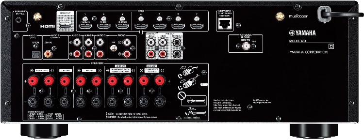

Sachb
After a little research I also found that people who have upgraded from 1080 to 2700h have been mostly really pleased. Also for me the Denon is the cheapest of them. One thing I am curios about is if in future lets say I wanna do 7.2 system, will Denon be sufficient enough with powering all the speakers, or is than a separate amp necessary. But yeah as of now Denon 2700h looks like my go to receiver (unless you guys have any other suggestions for even better receiver in this price range).
The denon X2700H doesn't have pre outs at all, while the yamaha V6A does have preout for Left & the right channel but not the center which might ruin the balance in the front stage.
The preouts is for taking load off the reciever by making a use of an external amp.
Sent from my LM-G710 using Tapatalk
