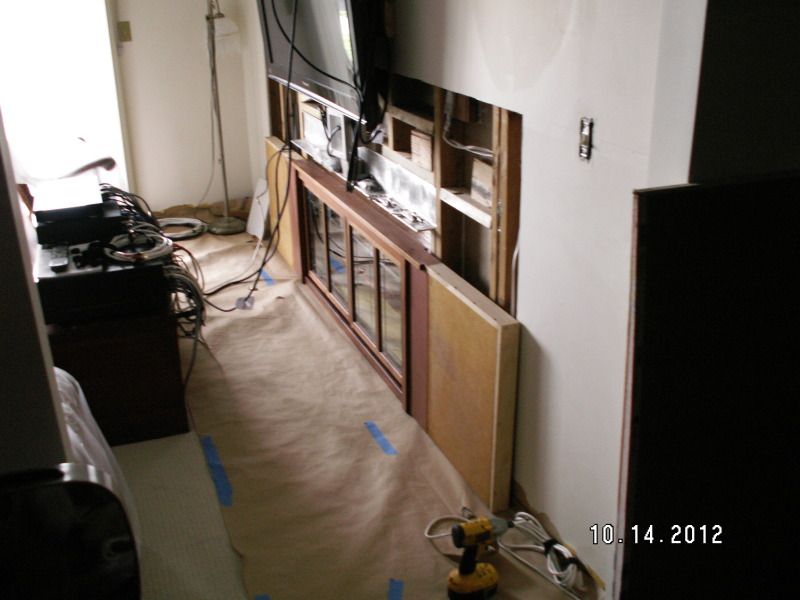

I found these and I'm seriously considering adding a bunch of them to my entertainment stand.
I think just one for the rec'r might be a good start. How about wheels for the EC?

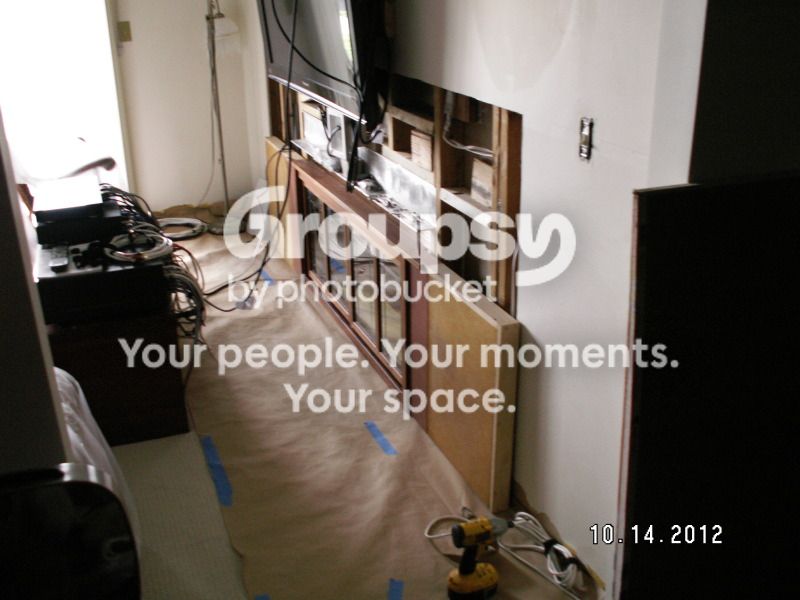

Will the fronts of those pockets be covered by something?
Yep, drywall with a plastic trim up to that wood grain plastic laminate. That plane will flush out with the corner bead (behind the 2 sheets of board leaned on the wall) in this pic.
How do the speaker wires for the fronts go from the receiver/amp to the speakers?
I'll drill holes in the top part of the cabinet that is directly under the wall. Once the wires are in the wall I can route them wall plates just outside the edges of the door pockets. The center channel wall plate will probably be in the aluminum beam.
If you can't keep the rear hatch open, you could always cut some holes in it to allow passive ventilation.
No more cutting. :D
The shelves look very wide without supports in the middle. What can you do if they sag under the weight of stuff?
3/4" x 3/4" Mahogany sticks placed vertically beside the equipment will take care of that. The shelves are only deep enough to catch the feet of a rec'r. Everything past the feet will overhang the shelf so it will be pretty much out of sight.

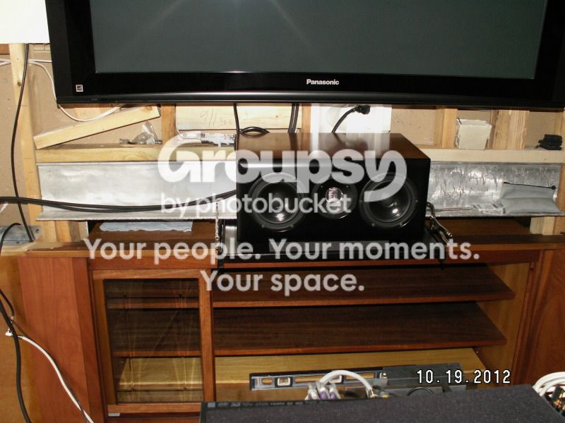

I don't get the part about the mopads. Where is the center speaker going?

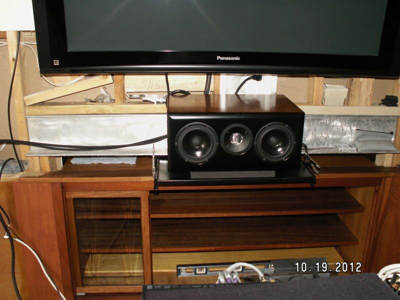

Here's a temp mock up of the sliding shelf that will be fastened to the beam.
Retracted:
Extended:

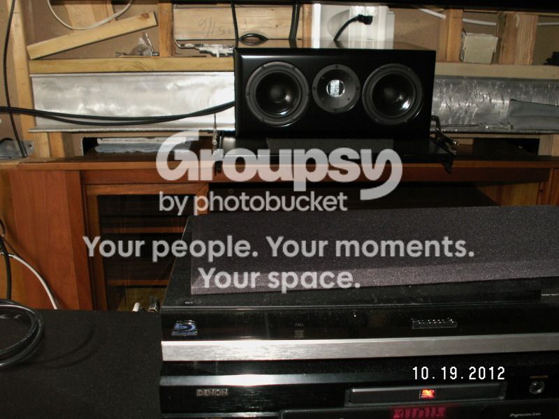

Here's the yo-yo-yo deal-io ...

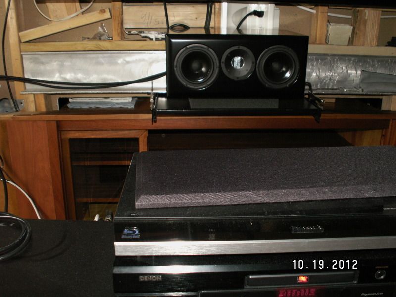

It looked better without the flash and the different angles were about showing the space/rise of the MoPads. I put a couple of 'em under there sideways. It works, it's out of the way and it will not hard the ever loving finish. Oh yeah, the other angle was to try and show the grain off but I sort of missed the mark on both counts but but but I was only gonna spend so much time moving a tripod around that congested mess.
I need to do a lot of little things and let me tell you that they are all going to take about forever. First is to mod up that shelf suspension, drill holes for wire routing and take everything apart to access beam for ... well, lots of little things. This is the best part of my weekend so far.

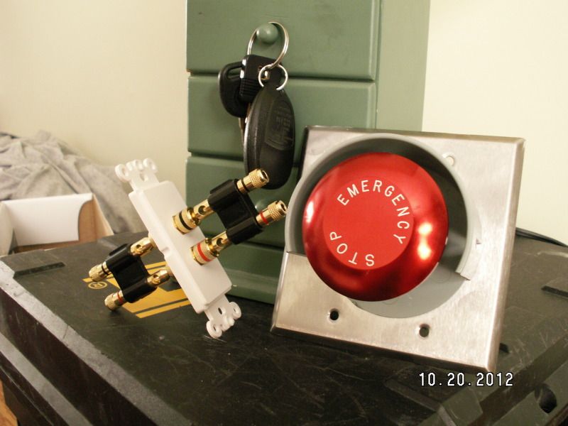

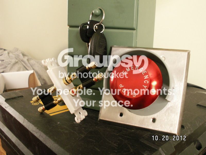

I was trying to be a clever plagiarist but really just want to show everybody
the coolest off switch I've ever seen. I'm gonna wire it to Cheryl's mouth. :eek::D
