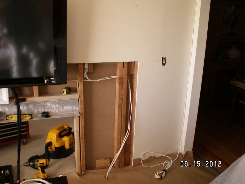

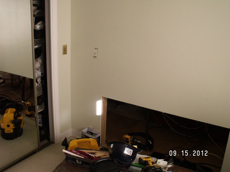

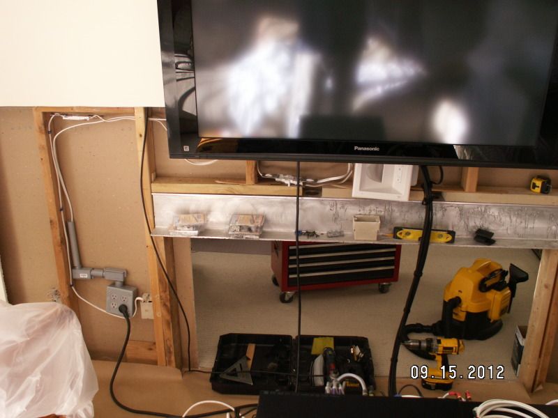

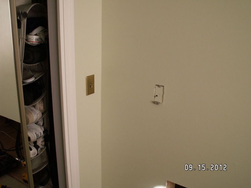

I guess I'll start here. I moved that switch.
Here it is in the bigger picture. It's the closet light switch and positioned where it was it always ended up behind something. At first I installed a light fixture with a pull string but it just seemed like an amateur solution to a simple problem.
Now on the other side you can see where I tapped into the overhead lighting circuit at that switch and I tapped into the neutral from the Recessed Media Plate that I installed a surge protected duplex receptacle into. That's what I wanted to ask Rick about. Is that allowed? That's the two Romex hanging on the right. One has the hot and the other has the neutral. I want to use that overhead lighting circuit to power up a couple of lights that I would install into a sofit that I will eventually build over the seating/viewing position.
This is going a little backwards now but here's the terminated receptacles in the Media Wall Plate and the gray receptacles on the left in the wall will eventually make their way into the entertainment center. Notice the TV is hanging on the wall with the studs cut as opposed to laying on the floor with a cracked screen? Yep, I'll be taking all the credit fort that.

Alex, on the electrical, where are you pulling your hot from? It does not sound like you are simply adding another outlet to the circuit path here. You should be pulling Hot, neutral, & ground all from the same line coming in. Have you also checked first what the total load would be on the circuit both prior to and after your new out let would be added??
Do you have easy access to your panel and can anew line be run relatively easy? My first recommendation, panel size willing, would be to add a dedicated 20 amp line to your outlet on its own breaker.

Alex2507
Alex2507
Rick has been working with me on this and straightened me out on that score too. I was trying to pull a neutral from the LR circuit for the pre-switch hot on the overhead lighting circuit that is my BR closet light. I'm going to have to open up my closet ceiling for that move. Bummer but it's only a closet.
The real load would be unchanged from before the addition of the outlet behind the TV but I haven't calculated what that is. All the same stuff will go onto that circuit.
The overhead lighting circuit will see some additional lighting ... later on. Right now I just want to be able to tap into that circuit for future use. I'll figure out the particulars for that then.
I'd have to tear into more ceiling than I'm prepared to patch and paint to add a 20 Amp breaker. Things have been working fine for years on the 15 amp breaker that the LR system is currently on.
