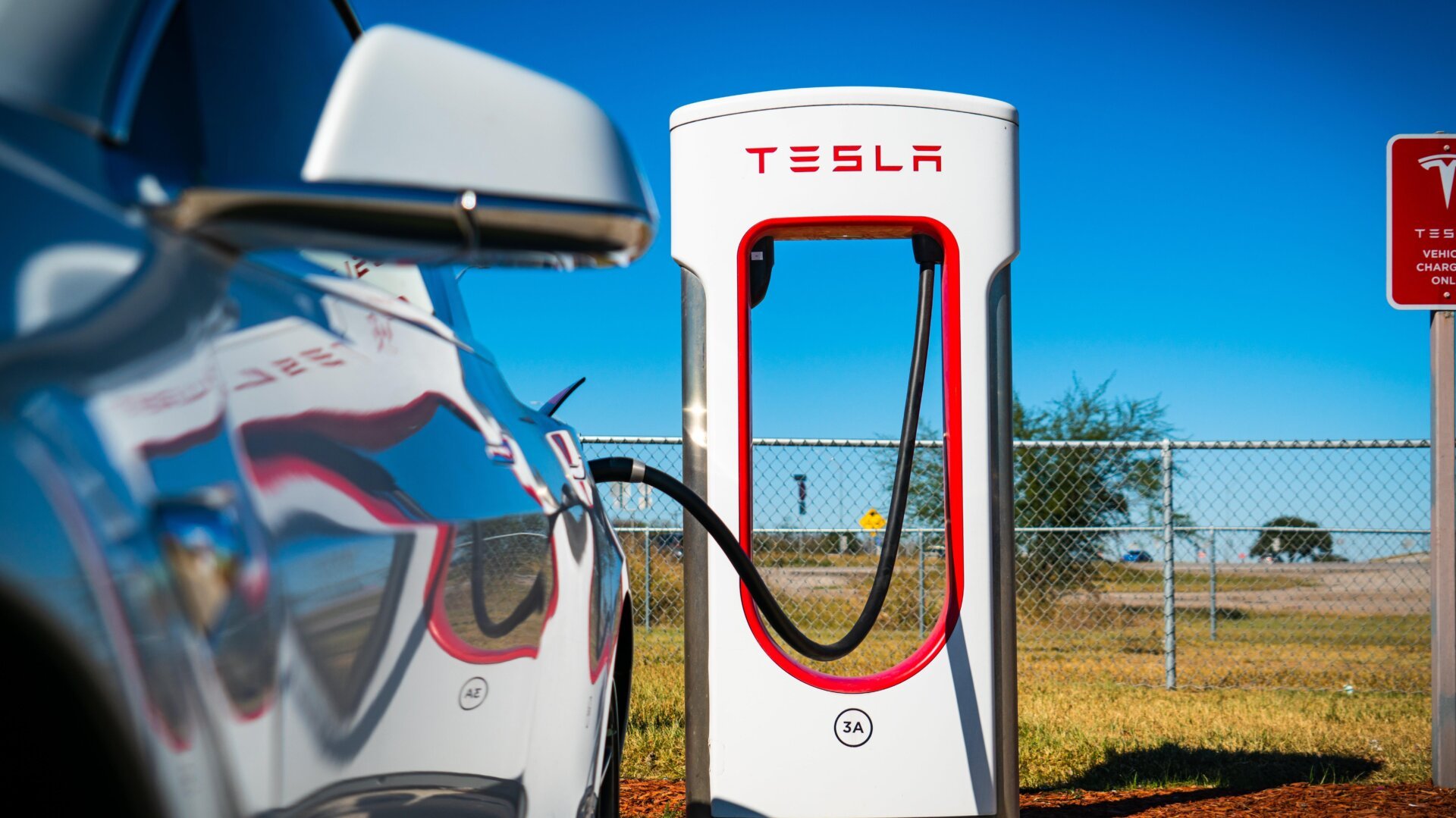

Apparently (if I understand things correctly) any EV can now charge up at a Tesla Supercharger. I can do it now if I want. Several things are needed:
  1. Download the latest version of Tesla's app for your smart phone. I looked it up and found it on the App Store. Set up a new account, specify your EV, and enter credit card info for payment. Easy enough.
  2. Telsa is in the process of modifying it's charging towers to add, more power, longer cables, and something called Magic Dock. It's a built-in adapter that converts the standard Tesla charger handle to become a CCS1 plug, such as I need for my Volvo. (I wish Tesla hadn't used a trademarked buzzword for this important feature. I usually ignore buzzwords as meaningless salesman jargon.)
Right now, there are probably only a few sites with these Magic Docks. Within a year there should be many more. I finally realized all this when I read this:
When the Magic Dock is locked, the station can be used normally by any Tesla owner, but when it is unlocked through Tesla’s app, both the charger and the Magic Dock get pulled along with the Tesla Supercharger handle to become a CCS adapter – allowing it to be plugged into most electric vehicles.
No NACS-to-CCS adapter is needed – it's built into the Tesla charging tower :). I had previously thought I would have to buy my own adapter.
