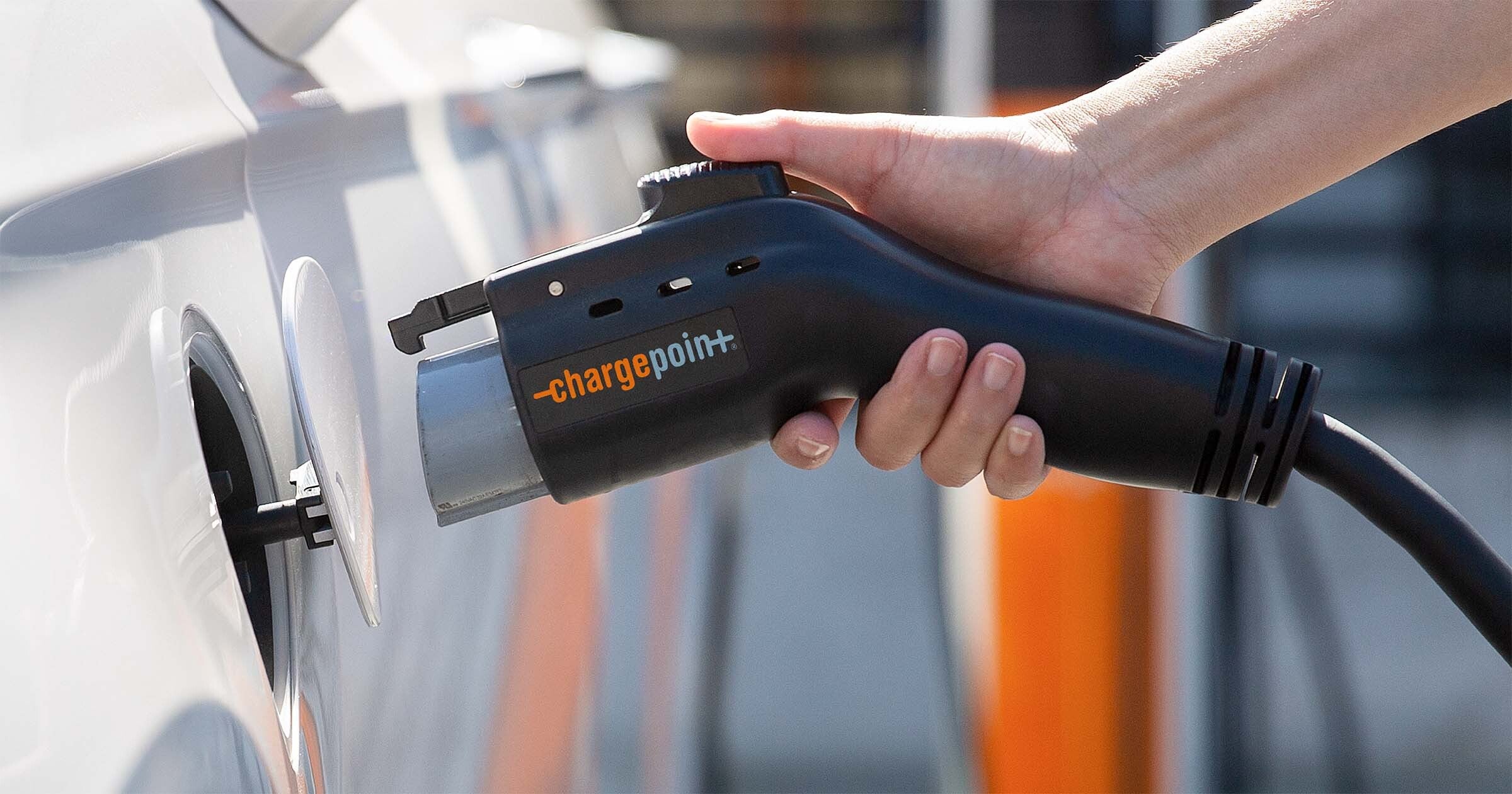

Cheaper chargers, for ~$400, have no software to select different amperage, or to select a time frame to begin & end charging, allowing lower electricity rates.
I chose the ChargePoint charger. Amazon has it for $919. My Volvo dealer gave me a link to order it directly from ChargePoint for $750. It allows the user to select the amperage from 16 to 50A, making that variable easy to deal with. It may be overkill, but at this point, I don't really know what features I'll need, until I've done it a few times. In the long run, extra flexibility never hurts.
