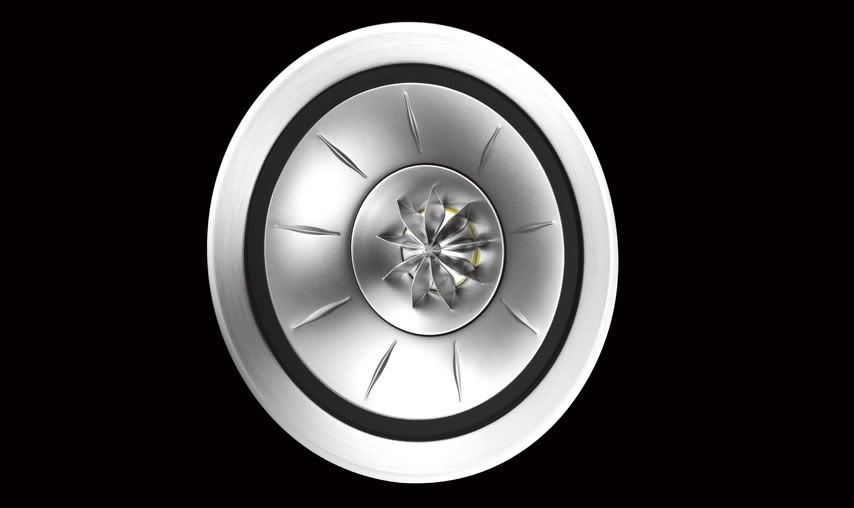

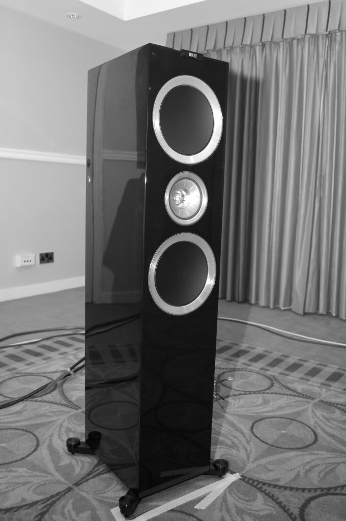

Kef r900
I am still trying to figure out what is wrong with this KEF R900 speaker. :)
Does anyone like/dislike its features/design and/or specifications?
Please CHIME In...
UniQ (MF/HF) Driver
Side View CutAway
KEF R900 Tower
Specs at: United States - Showroom - R900
Please CHIME In...
