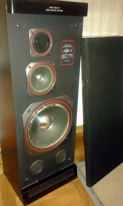

As for old cones, this was blaring my youth off:
These were made in former Yugoslavia from the Elak blueprints. This example also shows the first thing that went on these, It's the suspension. It was made from some rubbery sponge that would decay sooner than anything else. They were extreeeemly cheap, so you might say the sound was outstanding. For the price of a pair you couldn't even buy a mid-price Pioneer deck.
But it's a three-way, it doesn't help with the 12, 14 or 15" cone that plays mids and lows. The example I posted doesn't have some hidden down-firing, or passive radiator, or some transmission inner construction.

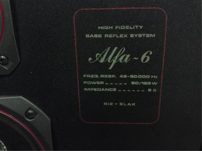

You can see here "RIZ - ELAK" sign and some specs.
It looks like it says 8Ω on the back. I thought CVs were 4Ω speakers? I'm gettin old and forgetful though. Been a few decades since I've even seen any CVs. :confused: I remember when CVs and Bose 901s were all the rage.
killdozzer
killdozzer
This is not a CV. It's probably the red circle around the driver that made you think of CV. These are RIZ speakers (Radio Industrija Zagreb - Radio Industry Zagreb). It is the electronics company that made the first television set entirely produced in former Yugoslavia. It made tuners, turntables, amplifiers, transmitters and army electronics.
Oh, ok. Jeez, now I feel like an:

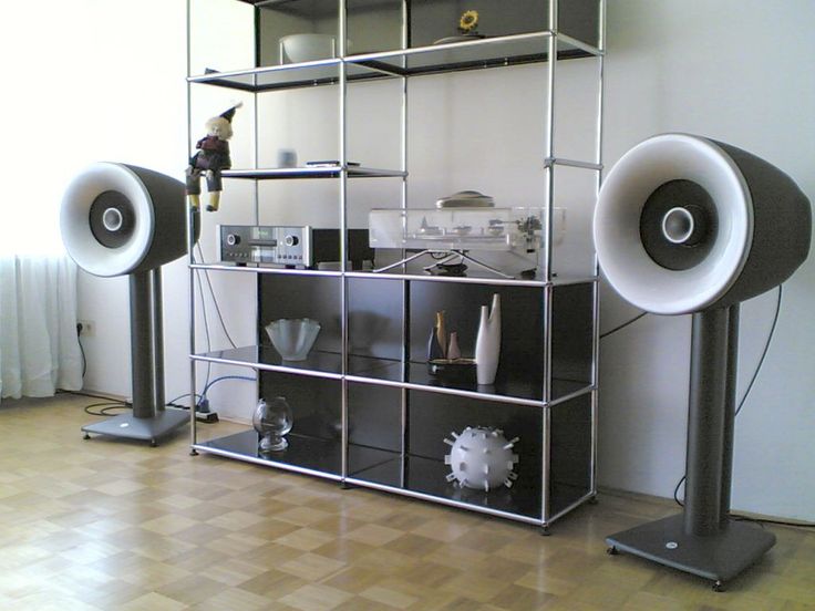

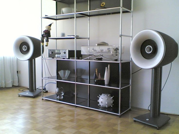

@yepimonfire
You seem to genuinely appreciate horn design, that's why these made me think of you:
Somehow I feel you'd have months of joy exploring these. Combining them with two subs perhaps to get a state of the art sound. Check how much settings they offer with active XO's, strong inbuilt amps, EQ for bass and mids... Dual Concentric horns should image heavenly:

@yepimonfire
Never seen these before. Look typically German, no? And talk about efficiency? Seems like an amp would be superfluous. To think, you get hook up some crappy receiver and probably get some amazing playback.
