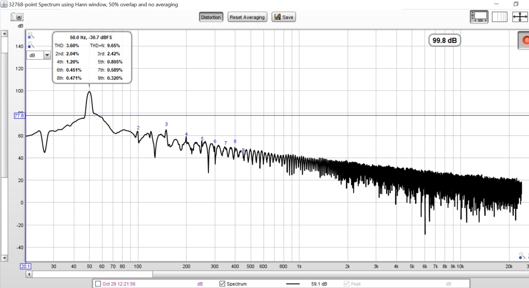

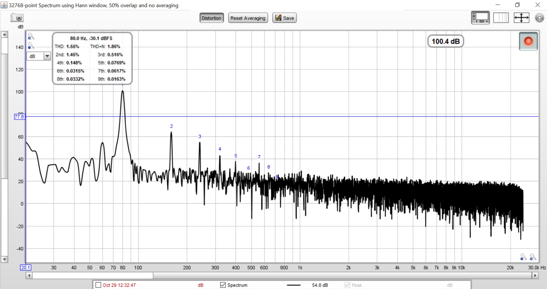

@Steve81 if the sub can extend to 120hz linearly, and is either placed along the front of the room or multiple subs used, you might have good results with a 120hz xover. This is entirely room and speaker dependent though. Crossing my LCR over at 60hz gives me the flattest response and best sound. My speakers actually do a better job at 60hz-120hz than my sub, and I have no issues listening at the ridiculous volume levels i often use.
This is the distortion of my L/R speakers playing a 50hz tone at 100dB 11 feet away, which use 5.25” ceramic/aluminum woofer
This is 80hz @100dB
From 50hz-200hz, I’m able to get about 102dB before distortion starts climbing rapidly.

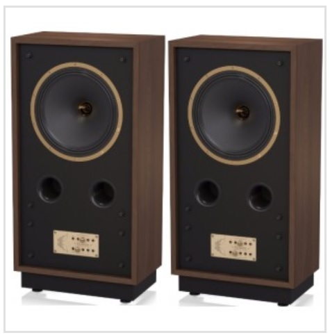

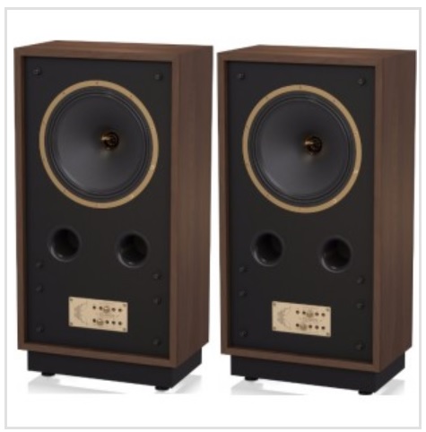

Well, check this one:
This is Tannoy Cheviot. It has been produced for decades which makes it all the more difficult for me to believe that it would continuously go out with such obvious inherent flaws. It goes for 6800$. It has some sort of tuning option:
and these are the specs:
- Frequency response: 38Hz-30 KHz ±6dB
- Recommended Amplifier Power: 20 - 250 Watts
- Power handling: 125 W continuous,500W peak
- Sensitivity: 91dB
- Impedance: 8 O
- Crossover: 1.2 kHz
- Connectors: 5 x 4 mm 24ct WBT binding posts
- Dimensions HWD: 860 x 448 x 260 mm
- Net weight: 29 kg
That driver is 12" for mids and lows!! (it's bigger than some people's subs).

This is the distortion of my L/R speakers playing a 50hz tone at 100dB 11 feet away, which use 5.25” ceramic/aluminum woofer...From 50hz-200hz, I’m able to get about 102dB before distortion starts climbing rapidly.
So with two speakers driven, you can get up to 102dB 50Hz-200Hz without distortion becoming a major issue. What about just 1 speaker, 120Hz-200Hz vs 50Hz-120Hz? That's really the comparison I'm getting at with a 120Hz XO.

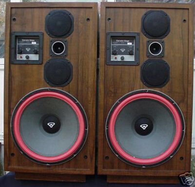

That reminds me of my old $300/each Pioneer speakers that had 1" tweeter and 15" mid/woofers. :D
I had some Pioneer speakers with 15" woofers I bought in '78. My first real speakers. I was a kid (17) and 15" woofers was some serious bragging rights. lol Bought them at a stereo place called 'Dixie HiFi'. They went out of business a very long time ago. It was setup like a warehouse. That's also where I bought my Pioneer reel to reel. God, I'm gettin old. :(
I really shouldn't say they were mine. I talked my father into it. :D
Maybe those Pioneers were the same ones. :D
Consumer Reports rated them #1. Oh yeah. ;)
I can't even recall where I bought those 15"-woofer Pioneers. But I know I bought them brand new from some big name store.
But I do remember enjoying those speakers for a long time. :D
