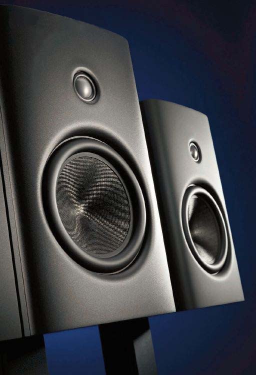

And what in god's name do you get by giving 25k for these:
Magico Q1. How much can they do with a conventional architecture?
Hetfield
For 25K it better come with a date with Jennifer Lawrence or it's a total ripoff. Talk about the law of diminishing returns. People are nuts with this stuff.
All of the Magico speakers I've heard have sounded very good. Comparable to Revel products. That's unusual in these boutique speakers in my experience; many aren't very good. The Magicos are made from CNC-machined aluminum, which gives the entire product a jewelry-like appearance you can't get with wood cabinetry, and some people find them alluring. As I've pointed out before, if you're really wealthy, say $50M or $100M or more in investable assets (I know many people in this category), $25K is a nit. Your portfolio varies in value more than that in an hour when the markets are open. The spectrum of wealth in the world is greater than most people like to think about.
Hetfield
If I were a millionaire I'd probably feel differently but I'm not. I don't know anyone in the position to even buy something like this. My pickup was 38 grand. These speakers are almost as much.
