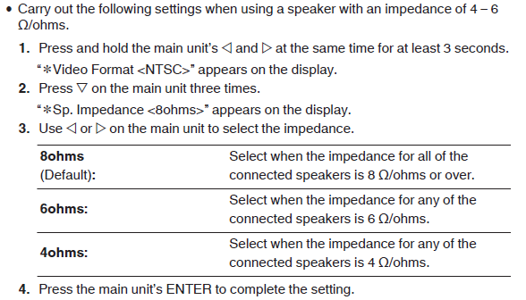

I was a bit curious as well, and this appears to be the case according to User Manual RX-A1080 page 23:
Under its default settings, the unit is configured for 8-ohm speakers. When using a 6-ohm speaker for any channel, set the speaker impedance to “6 Ω MIN”. In this case, you can also use 4-ohm speakers as the front speakers.​
That said, it does not explicitly warn about using more 4-ohm speakers.
Edit: The user manual for A2080/A3080 has the same wording.

I don't believe that's actually true, Yamaha has never stated their AVR'S can't or shouldn't be used with 4 Ohm rated speakers. Didn't Gene test out the A860 a year ago? He did find that unit was a lil under powered for a Yamaha advantage unit. If I remember correctly he Gene even said not to switch to 6 Ohms, to just leave it set to 8 Ohms even if your speakers are rated at 4 Ohms. Maybe (PENG) will chime in give us his thoughts on this. I can say My Son has the A1050 drivering LSi-15's Center, and LSiFX surrounds All 4 Ohm rated speakers never has his AVR tripped off. And he runs it at -0 to +3 a Lot! He's a heavy metal guy!!
I think that similar language is fairly common among the various avrs as regards the impedance switch....
The manual for my Denon AVR-X4200W (2015 model) just says to set the impedance to 4-ohm if any connected speaker is 4-ohm, though, so Yamaha is just trying to cover all the bases? I've got 4-ohm speakers but have not touched the dreaded impedance switch :)
Close enough :) Yamahas were often thought to be fine with 4 ohm speakers even without specific ratings, but that was a few years ago and there was the disappointing AH testing of one more recent model....
