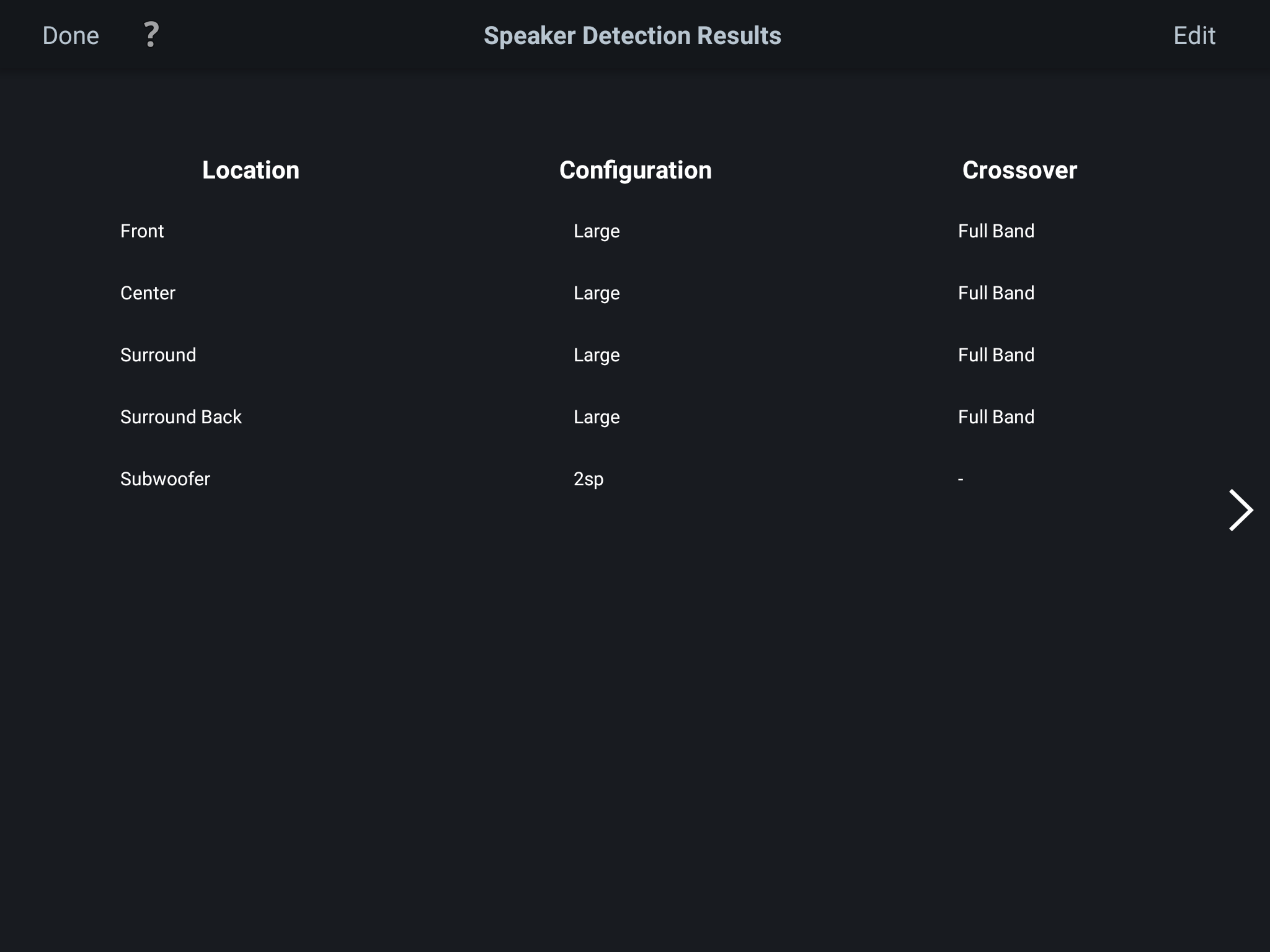

Danzilla31
HD has given you the correct click and select/press sequence, that is:
Click Setup on the remote to see the Setup menu
Select "Speakers" on the pop up menu to see the next pop up
Select "Manual Setup" to see the next pop up
Select "Speaker Config."
Now you can see that your front and center speakers were set to "Large"
Change them to "small"
Go to the crossover pop up menu and set them all to 80,90 or even 100 Hz to avoid/minimize clipping the XLS1002.
Audyssey did not set them to "large", it reports the findings to the processor, it is Denon's algorithm that determines the "large" and "small" thing. Audyssey sets the levels and generate the necessary EQ filters.

Finally got to looking at these settings last night.... Still didn't have time to play with the settings. The setup, following the Denon on screen using Audyssey, is:
Speakers: Small (all)
Crossover: Front/Center: 40Hz, Surrounds/100Hz
Subwoofer Mode: LFE
LPF for LFE: 120Hz
Where to go from here? Just tweak the front/center crossover? Forty seems low. Shoot for 60-90Hz?
Manual says try LFE and LFE+Main with music playing. It's not clear whether this matters when the speakers set to small?
Anything else to try? Am I missing an important setting? I'm surprised Fronts/Center are set small with a crossover at 40Hz.
Curios if anyone has tried the "Restorer" setting? I have it set off.

All look good except the Front/Center crossover. Change them to 80 or 90 Hz and you will likely get flatter, that is, more accurate bass response. If you feel like you need more bass, simply increase the subwoofer levels (not at the sub, but on the AVR only) by 3 to 6 dB and go from there. What are you front, center speakers again?

With those big KEFs, definitely try XO 80 on the mains and 90 Hz for the center. The Q900 and Q600 have strong output down to 40 Hz or lower in room so they will cancel/boost the dual PB1000 especially if the room is not too big. I am guessing your room is small to medium otherwise you would have opted for dual PB2000s.
Audyssey doesn't set crossover points and Denon/Marantz typically set XO as low, as possible, even full band for whatever reasons. Contrary to popular beliefs, tower speakers with good bass response are more prone to messing up the bass, along with the subwoofers.

Audyssey doesn't set crossover points and Denon/Marantz typically set XO as high as possible for whatever reasons. Contrary to popular beliefs, tower speakers with good bass response are more prone to messing up the bass, along with the subwoofers.
Interesting, I would assume Audyssey would set the crossover points. Either directly, or indirectly by suggesting a range. I assume you meant the xo as low (low freq) as possible? In my case it chose 40hz.
It actually makes sense that a speaker with good bass response along with a subwoofer would be more confusing to the setup. It confuses me thinking about it.:eek: In my head I kind of want to take advantage of the towers... then again, not.

Yes, I meant as low as possible. Thanks for letting me know so I can fix it. Someone (@lovinthehd iirc) suggested that they want their customers to feel good about their speakers, and not insulted for them being small:D.. Have you seen the graphs I posted, for 60 Hz vs 80 Hz? You would have seen the big suck out/valley in the 60 Hz scenario.

Below is right from Dr. Chris Kyriakakis:
https://audyssey.zendesk.com/hc/en-us/articles/212345023-Crossover-frequency
Audyssey Labs
February 04, 2010 21:23
Audyssey doesn't set crossovers in any product. It finds the low frequency roll off point of your speakers and reports that to the AVR. Every manufacturer uses that information differently. In your product, speakers found to roll off below 40 Hz are set by Onkyo to Full Range (i.e. with no crossover to the sub). That means that bass will not be redirected to the sub. Audyssey recommends that if you have a sub you should set crossovers for all your speakers. I would suggest starting with 80 Hz. I wrote much more on this topic here:
IMO, the more complicated REQ system such as Audyssey, Anthem ARC, Dirac,, Trinnov etc., are not for everyone, especially bass heads who happens to have strong room gains in the right place and couldn't stand their bass being brutally levelled.:D The fact is, like many features riched AVRs, you have to really read, understand and follow instructions in order to benefit from the products.

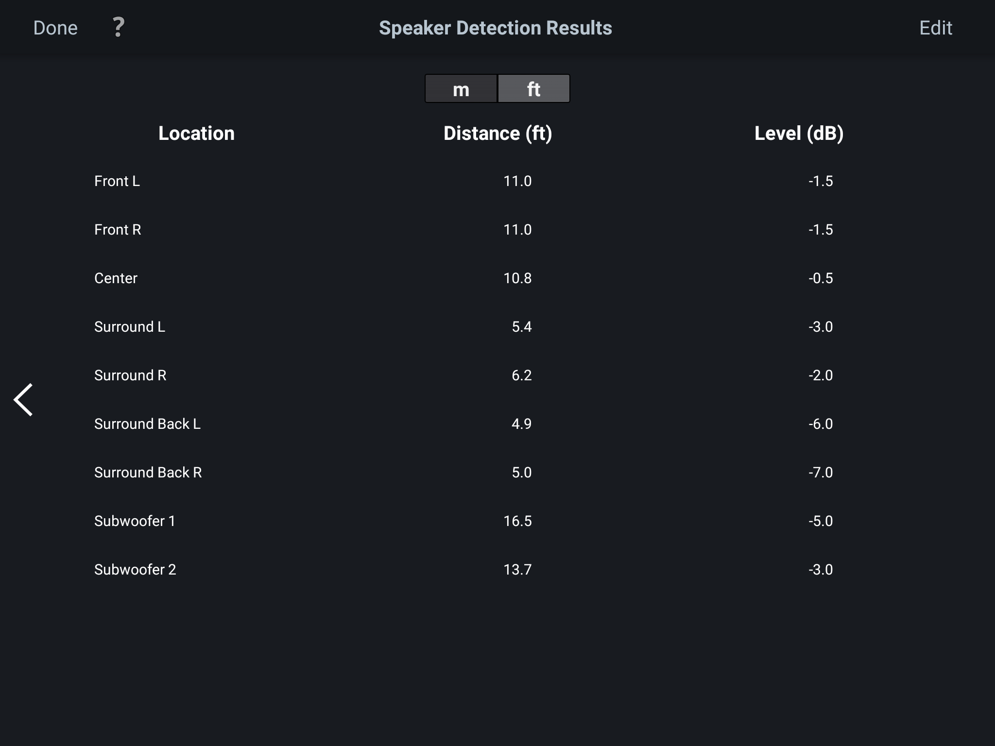

Would be great if we can share our Audyssey settings, so we can all see how they compare with others!
Screen shots of my Audyssey settings:
Note: I changed all speakers to small, XO to 80/90/60/40

Interesting, I'll take a look at mine tonight. Another confusion is what does large/small really mean? After our discussion yesterday it doesn't seem to mean much. Even more so if you go in manually set crossovers.
I did start changing my crossover setting yesterday. However, I didn't get enough time to compare it to the original settings. Been burning the candle at both ends lately...
