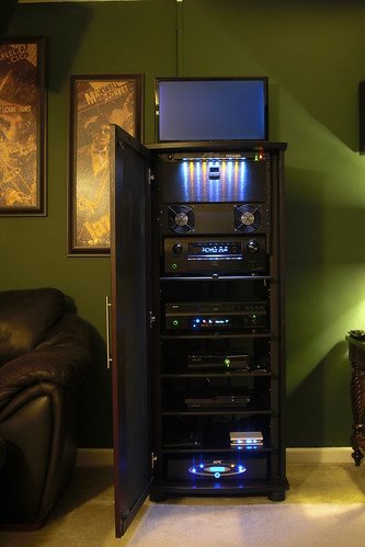

Pic of Rack with monitor.
The rack with the monitor set-up so the PJ doesn't need to fire up for things like streaming music etc..

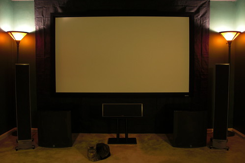

Nice rack. The only thing that bugs me about the theater is the window/drapes behind the right side of the screen. I'd probably just buy one big curtain and make it even :D
  • Like
Reactions: Cruise Missile
It's making me crazy also. I will be doing something about soon hopefully. The plan is to put in some room treatments and then put in a stage type curtain behind the screen.
The screen had to be mounted out from the wall in order to clear the window frame. I used 2x4's to move it out.
The black velveteen covering the window is intended to be used to cover the entire stage wall, and will be once I put in the room treatments.

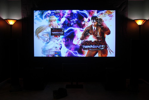

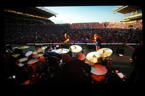

For grins and giggles I tried a couple of screen shots. Please understand these were taken with a tired casio point and shoot, so the quality is not represenative of the on screen images.
