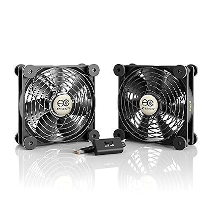

By the way, it may be a good idea to get a quiet usb fan to blow air from the back or from the top.
In case you are floundering over what to get, this is a pretty nice kit for $20 US:
https://www.amazon.com/gp/product/B00JLV4BWC/ref=oh_aui_search_detailpage?ie=UTF8&psc=1
I just put mine atop the warmest areas and leave on the low fan setting. The fans cannot be heard more than a couple feet away (in a quiet room) while the AVR temp stays down close to room temperature!
One of the best features is the silicone pads you can see in the picture. These prevent vibrating the AVR's cover.
