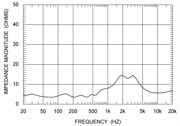

Take a look of the Salon2's impedance curve:
https://www.soundstage.com/measurements/speakers/revel_ultima_salon2/
The impedance of a driver is quite complex, but even if you look at the voice coil of the one you linked in isolation all by itself (without considering the crossover and the enclosure effects),it has resistance and inductance. The inductive reactance (the inductive part of the total impedance) will naturally increase with frequency. So I am quite sure the impedance increasing trend starting at 10K will keep on rising as frequency increase, and that means the higher frequencies voltage components due to clipping will see higher impedance of the tweeter as the frequency of the harmonics increase. That would have the tendency to limit the increase in the harmonic currents due to the clipped voltage waveform. There are many factors and variables to consider, making it hard to generalize in one way or another.

The impedance of a drive is quite complex, but even if you look at the voice coil of the one you linked in isolation all by itself (without considering the crossover and the enclosure effects),it has resistance and inductance. The inductive reactance (the inductive part of the total impedance) will naturally increase with frequency. So I am quite sure the impedance increasing trend starting at 10K will keep on rising as frequency increase, and that means the higher frequencies voltage components due to clipping will see higher impedance of the tweeter as the frequency of the harmonics increase. That would have the tendency to limit the increase in the harmonic currents due to the clipped voltage waveform. There are many factors and variables to consider, making it hard to generalize in one way or another.
If it limits the increase in Current (Heat Energy), does that mean less Heat Energy could go to the tweeter?

Absolutely, the relevant formula is:
Power = Current)^2 x Resistance (P = I^2 x R), therefore the heat developed in a resistor:
Energy = Power X Time (duration) = I^2 x R x T
The inductance of the voice coil won't contribute to heat, but it helps limiting the current especially at the higher frequencies, thereby also helps (only helps) limiting I^2 x R x T (I being the current, note the square relationship).
Another note, more heat energy means higher temperature and that means the resistance (R) of the voice coil will also increase, further reducing the current increase due to the increase in harmonic contents.
Again, I am not saying that a flat topped wave form created high order harmonics won't threaten a tweeter, because it certainly could, and may.. Just that one should not overrate this point to a make blanket/generalized statement about less power being more dangerous than too much power. All I can say is, and you said yourself, it depends, that's all.

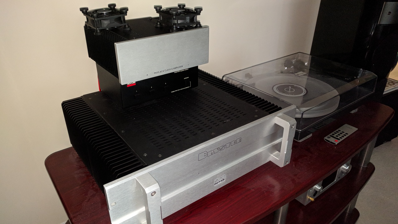

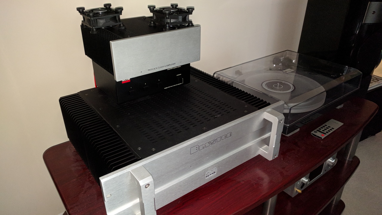

Of course, your Kanto No.2 has specs very similar to my 1028 Be. Guess what's driving them in the photo attached..
It's the little 5 W amp, and I checked with my RS spl meter, at 70-75 dB it sounded about as good as the big one it's sitting on.:D

Nice looking Bryston amp. :)
