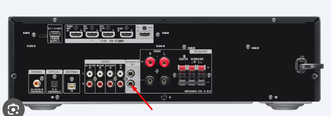

I thought it would be easy but I don't know why is not working
I bought this RCA cable https://www.amazon.com/gp/product/B003FVYXY0?ie=UTF8&th=1 and connected it to the Sony STR here:
I connected the other end here:
But I'm not getting any output please help!

You have one sub, so use the top sub out. Have you done the set up, as per the manual. You need to select 5.1 to get the sub to output. Advance the crossover on the sub fully clockwise.
Now do the set up with the microphone. Do you hear sound from the sub during setup?
Read your manual carefully. Most of these problems that we get are caused by people not reading their set up manual and or not following it.
