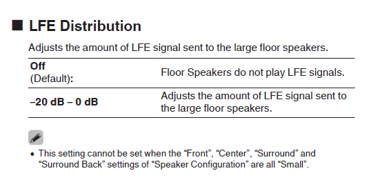

I should have been clear, for the older models (before the Xx800h), and Cinema x0, the manuals would simply say something like:
and
So, the fact that when the mains are set to "large" and sub set to "no/none", the LFE signal will be included in the mains was not explicitly mentioned in the manuals.
In the current models, since they added the "distribution" setting, they had to make it clearer (I guess...).
This particular questions had been asked on forums many times, I presume, and I remember speaker manufacturers such as SVS and Polk Audio, who make satellite/subwoofer systems that they often would recommend their users to set those tiny satellite mains to "large", if the speaker (high level) inputs are used, in order not to lose the LFE channel information.
Anyway, the OP's question is about the X4800H, so he has the clear affirmative answers to his questions, based on the info in the Owner's manual.

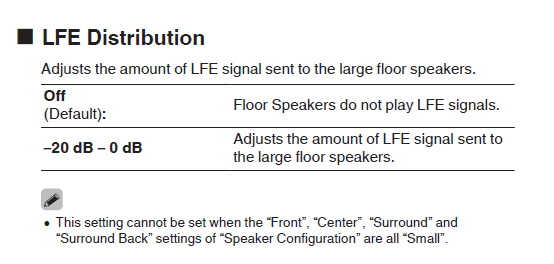

Sorry I wasn't clear, in the manuals of those previous year models including the AV7705, it will work the same way as the current models, but without the distribution settings. The manuals do cover the "large" setting but it does not explicitly mentioned the LFE info will be routed to the mains set to "large", but it will be as long as you set the subwoofer to no, or none whatever it's called. For the OP's X4800H, it is clear, explicit as quoted from the manual.
and
