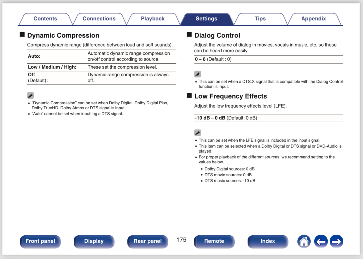

Yes, LFE is sent to Large speakers when NO subwoofer is present. Yes, there IS a way to adjust the LFE Level when using NO subwoofer. I should have been a bit more clear myself. The Low Frequency Effects Level setting applies to ANY speaker outputting the LFE, not just a subwoofer.
Be mindful of the -10dB setting when playing DTS Music. I can tell you my DTS music discs come in hot.
The Low Frequency Effects adjustment is NOT available. See my previous post above, and this picture:

You are confusing the LFE Distribution setting with the Low Frequency Effects Level setting. They are separate settings in separate sections of the setup menu. The Low Frequency Effects setting should be adjusted and set first and then, if using a subwoofer, you'd select the amount of that newly adjusted LFE to distribute to the Large Fronts.
That was my understanding also. So, as far as I can tell he would have to say he has a sub when he does not.

A connected subwoofer is only necessary when one wants to use the LFE Distribution feature to send LFE to the subwoofer AND to the LARGE speakers. When NO subwoofer is used, the LFE Distribution feature DOES NOT work because the LFE is AUTOMATICALLY sent to the LARGE speakers BUT the Low Frequency Effects Level IS still adjustable for the LARGE speakers that get the LFE when NO subwoofer is used. I'm not sure how much clearer I can be about it. There is NO reason to concern oneself with LFE Distribution when NO subwoofer is used and this is why the Denon X4800H and others disable the feature when NO subwoofer is present because the LARGE speakers are already getting ALL of the LFE signal. That signal may prove too much and the Low Frequency Effects level can be adjusted accordingly. The low frequency range signals originating in the Channel for which the speakers are set to LARGE will still be FULL RANGE and output ALONG WITH the LFE signal that is NOT going to a subwoofer that is NOT used.

So, you say: " Notice that the “”Low Frequency Effects” level setting is NOT present in Subwoofer settings. This is because it is adjustable when using Large speakers and NO subwoofer. If it was only applicable when using a subwoofer, those using Large speakers with NO subwoofer could not back off the LFE at all."
Are you saying that with my large main speakers and NO sub, that the LFE is sent to the large main speakers automatically without any specific settings? In this case, there IS or IS NOT as way to change the level of the LFE?
