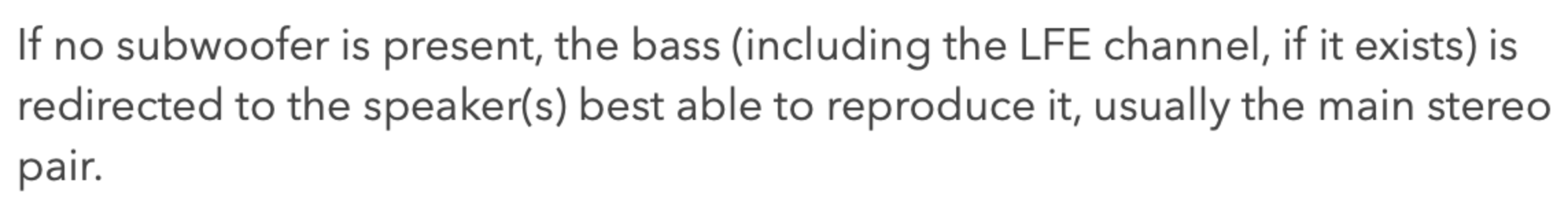

What is the disconnect here exactly? Can some not understand the difference between LFE Distribution and LFE Level? Can some not understand the difference between a down mix of multichannel signals and simply playing multichannel signals in Stereo Sound Mode. Here it is, AGAIN, from Dolby.

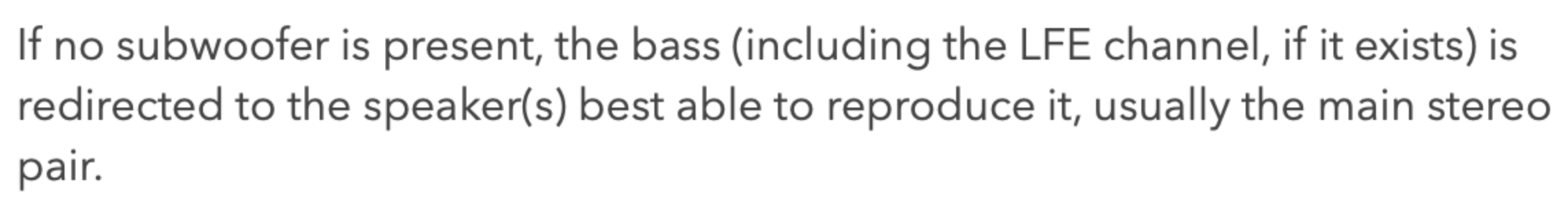

When NO subwoofer is present, in this case specifically, the information in the LFE channel of multichannel signals is AUTOMATICALLY output from the Large speakers. There is NO reason AT ALL to be concerned with LFE Distribution when No subwoofer is in use because the LFE information from the LFE channel is already being sent to the Large Fronts. This is why the LFE Level, NOT LFE DISTRIBUTION, can still be adjusted in settings so that folks can back it off a bit because it is AUTOMATICALLY included in the signal being sent to the LARGE Front speakers when there is NO subwoofer in use. This is why Fronts are AUTOMATICALLY set to Large when NO subwoofer is assigned for use.
When AVP/AVRs support Dolby decoding, multichannel signals are NOT down mixed at the receiving end. Playing back a Dolby multichannel signal in Stereo sound mode DOES NOT result in a down mix of the signal to PCM 2.0. Dolby signal processing can expand two channel signals into MORE channels for output and can also contract multichannel signals into FEWER channels for output. The LFE of multichannel signals will be output from the subwoofer even when switching from a straight decode of Dolby 5.1/7.1 signals to the Stereo sound mode. LFE is NOT lost in this case. If NO subwoofer is used, the LFE will be sent to the Large Front speakers.
Now, if Denon/Marantz has changed things up and NO LFE signal is output to Large Fronts when NO subwoofer is in use, like has always been the case with older units, and one must now assign a subwoofer and then use LFE Distribution to get LFE to Large Fronts even when NOT using a subwoofer, then that is just f#%ked up. I don't believe that is the case but the manuals aren't exactly spelling that out for those that cannot wrap their heads around it all.
PENG
That is exactly what I said some posts ago. Also if he mixes down to stereo, then he will not get the LFE channel. Anyone who made a device like that, would quickly be contacted by Dolby's lawyers. Dolby fiercely defend their specifications and protocols. If he mixed down multichannel to 2.1 and faked the sub then I think he would likely get the LFE channel.
As I have pointed out, his best and safest solution is a sub or two, especially if he is watching movies and playing the audio through those speakers. The LFE of quite a few movies could easily spell death to his bass drivers.

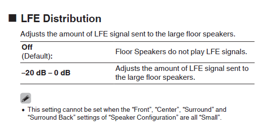

I think the "LFE Distribution" setting is for use in conjunction with those who prefer using the
"Directional bass" that D+M offers in the latest models, not that one has to do both, but it's there if they choose to. As I mentioned before, if the OP wants to have some control of the amount of LFE send to his towers, in his 5.0, that is, no sub configuration, he could try to still use the LFE Distribution setting by faking/cheating the AVR-X4800H, such as selection Yes to Sub, or actually hook a sub up (only if the AVR is smart enough to know there is no sub connected) but turn the volume right down, or,.... etc.
To me, that's too much to worry about, much simpler/better to use a sub or two and then just sit back and enjoy the music.
Trebdp83
The LFE Level setting is still functional for ANY Large speaker used to output LFE when a subwoofer is NOT used. There is no reason to cheat. The LFE Level setting can be turned down as needed. But, depending on the signal, some may find little or no difference in bass output from the Fronts when the LFE signal is sent to them and NO subwoofer is in use. This applies more to music discs than movies. Some soundtracks on new movie discs have gotten ridiculous and there is more bass in the Front channels than many realize. Some complain about too little bass on some movies while others complain about too much. But, how they have their speakers set up and adjusted has everything to do with it.

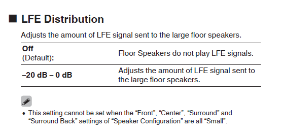

What the heck?
So, after all this discussion we've come to the conclusion that, yes, the Denon AVR-x4800h CAN send the LFE info to the main speakers even if you don't have a seperate sub, using the LFE Distribution control, as seen here on page 238.
So, I went to the settings to do this, and this is what I see. What the heck?
(click the attachment to see the message from the AVR. Can't get it to display as a picture)
Adjusts the amount of LFE signal sent to the full-range floor speakers. Can't be set when subwoofer is not used.
All of the latest Denon and Marantz AVRs can send LFE to the mains even with a sub channel active thanks to me asking for that feature for years. It will ONLY send LFE to the mains IF:
  • you set the mains to large
  • You enable LFE routing to the mains
  • You don't use DIRAC
None of the older Denon/Marantz or any major AVRs will allow LFE routing to the mains IF the sub channel is active.
