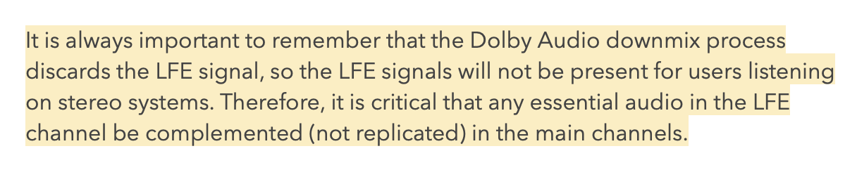

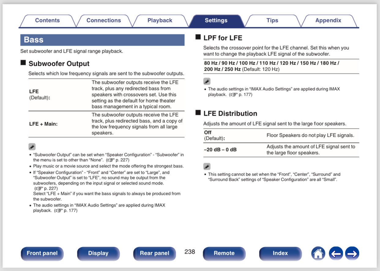

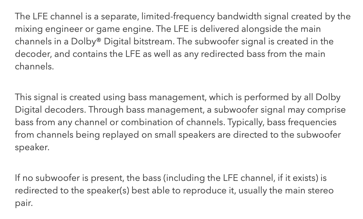

It's always good to get info straight from the source. Concerning Dolby LFE, their LFE Usage information for engineers and game engines is an interesting read.
Source audio output settings need to be considered for playback of LFE. Some may be unknowingly down mixing signals before they are output to an AVP/AVR. There will be no LFE signal sent to Large Main/Front speakers or any subwoofers that may be present. There may be an up mixer applied to the signal for output and some may believe that, because audio is coming from various speakers and any included subwoofers, LFE is present. But, if the incoming signal is 2.0 and NOT a multichannel signal, there is no LFE present.
Some do actually have full range speakers capable of handling LFE without much fuss. But, that doesn't mean a receiver used to power them is as robust. One or more powered subwoofers will take some of the heat off of the receiver and speakers and can be placed where needed while Large Main/Front speakers may not produce the desired level of bass because of their placement in the room.
Without a subwoofer present, the X4800H works fine. But, when using a subwoofer, the 2ch Playback setting from the X4700H was dropped and one has to go up to the X6800H to get it back. It allowed for separate subwoofer settings for two channel signals. So, one could have Large Main/Front speakers with LFE+Main setting applied for the subwoofer when listening to music in Direct or Stereo mode and use the Small speaker setting with a selected crossover and LFE setting for the subwoofer when watching movies with multichannel tracks. The X6800H also allows for adjustment of the frequencies copied to the subwoofer when LFE+Main is selected using the Bass Extraction setting.

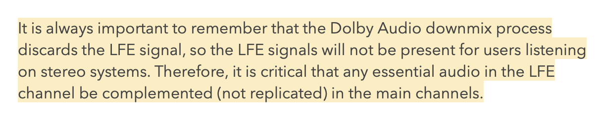

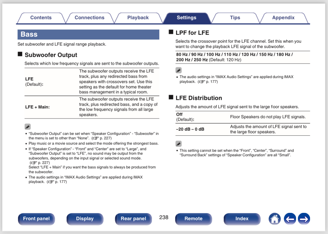

Thanks for that refresher course, and that is my recollection. The design of my AV room started 20 years ago in 2004. I was 57 then and probably had a few more neurons in my noggin.
An how the bottom line is that 2.0 can not contain the LFE by definition. So a 2.1 signal can contain an LFE channel.
The other point to understand is that the LFE is not the same as the sub output. Now we get to something people seem to refuse to understand.
The sub signal is a crossover. So the high and low pass will be where you set it. The LFE signal will always have a bandwidth of 3 Hz to 120Hz.
The LFE signal unless set to LFE plus main is on the sub outputs, but a portion can be sent to mains with LFE plus main to speakers set to large.
If you downmix to stereo, as I understand it, the LFE channel will be lost, unless there has been a change to Doly specs I am not aware of.
So, the LFE is in the the channels to the right side of the decimal point. This will have an FR out to 120 Hz no matter where you set the sub crossover.
So you need to make sure a sub has a a bandwidth at least out to 120 Hz. So if you want the LFE channel to be reproduced properly you must not set a crossover on a sub amp below 120 Hz, in fact you should set it as high as possible.

Yeah, experimented with settings and signals today. My head hurts. Those with no subs and capable Main/Front speakers set at Full Band/Large are spared many a headache and LFE gets sent to those Main/Front speakers. Add a subwoofer and things get far more complicated concerning different signals and settings using different AVP/AVRs.
Regarding LFE Distribution, it’s all over the place with Denon/Marantz. The X3800H and X4800H support it but do not include 2ch Playback settings. So, LFE Distribution setting will apply to all sound modes, not just Direct or Stereo modes according to the manual.The X6800H and Cinema 30 support LFE Distribution and 2ch Playback BUT LFE Distribution only works with 2ch Playback settings. Again, according to the manuals.
For those wanting LFE Distribution AND separate LFE Distribution settings for 2ch Playback modes when using subs, the Denon A1H and Marantz AV10 fit the bill. So, say one is listening to Dolby Atmos music. They can listen to it in its native form using multiple speakers using Small speaker settings with no LFE Distribution or use Main/Fronts at Large with LFE Distribution.They can also switch to Stereo mode and still use the Main/Front speakers at Large with LFE Distribution to feed them a bit of the LFE that is still going to the subs. But, why? Well, cuz’ these f#%kin’ toys cost a fortune and they better have as many features as they can cram in the f#%kers.
