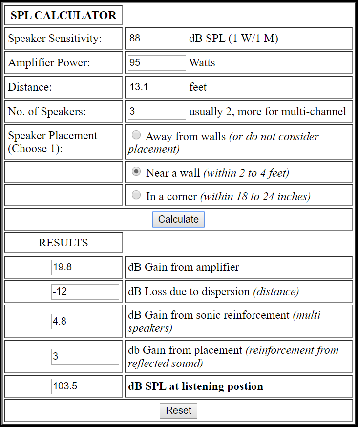

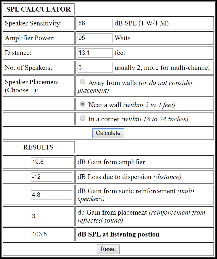

Pogre, thanks. I did that calculation before.
Here's a screen shot of what i put in. My seat distance is about 4 meters from the speakers, hence 13.1 feets. My AVR is rated at 95WPC X 2, so i put in 95.
I look at the end of this table, it shows 103db. Sorry for the dummy question, does this means that my current AVR is able to pump out this volume without clipping of damaging the speakers? Means i don't have to spend money to add power amp?
Phew. Well, I'm probably gonna need an assist on that question. First I see that you entered 3 speakers. You won't normally have all 3 up front playing the same thing at the same time. I always enter 2. As far as getting 103.5 dB continuously like that you'll likely damage something at that volume. 103.5 dB is incredibly loud tho, and you said your normal volume is less than half of that (-35 on the reference volume scale is about 50 dB where you sit after running setup) Like TLS explained those speakers can be difficult to drive so an amp would help your receiver out by taking on that difficult load, but that doesn't necessarily mean they're going to sound any different, especially at lower volumes like you use.

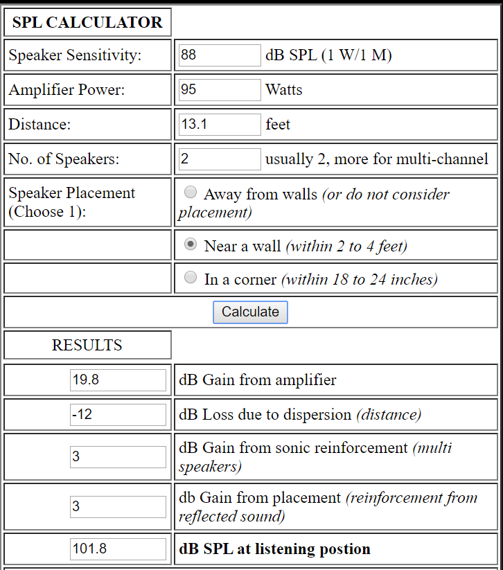

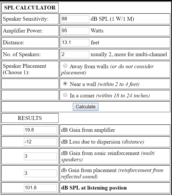

OK, i changed it to 2 speakers now.
And yes i normally run around -38db on AVR volume, the max i go is around -25db which gets enough volume to fill the room.
And as per TLS Guy recommendation, i will go back and changed the xo of the towers to above 80hz and see how it goes.
