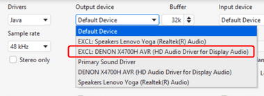

On the REW Soundcard page, I am having an issue with my Output showing “Not Connected”
Under Hardware and Devices/Sound, I have MY AVR X4700h selected by default. On pg. 26 of the guide, it says to install the ASIO4ALL Software. I did this, but when I select AISO for the driver, it won’t find any devices. I am able to see my PC desktop on my TV display.
On the REW soundcard page, when I change the driver to Java, my AVR appears in the Output Device List. Should I assume it's not a connection issue with my AVR since I’m able to see my AVR when switching over to Java? Does it maybe have something to do with the AISO driver I downloaded? This is all new to me so I'm not sure how to troubleshoot this.
Should I not have downloaded the ASIO4ALL software? I read online that the ASIO4ALL was used on an older version of REW to help with multi-channel measurements. Do I want to be able to do multi-channel measurements? I'm not even sure what running measurements looks like at this point or the options surrounding them. I have no knowledge yet of how to run or set up REW. My hope is to learn how to take measurements and improve the sound in my room. I'm spending a few hours every day reading guides and educating myself so I can eventually understand running measurements. Should I only be running JAVA and forget about the ASIO4ALL? I am not sure which direction to go. I just want to make sure I am setting everything correctly from the start

“Yes the current download of REW supports 7.1 on Windows using WASAPI exclusive mode already built in. On the Preferences panel you need to select the Java device and the EXCL Output Device for your AVR (shown below from you example above). This will allow you to do 7.1 multi-channel measurements. AustinJerry discusses this on page 42 of his getting started guide.

That's interesting. I tried a little earlier with Java but couldn't get it to work. I may have overlooked the EXCL set of devices though, not realizing what it meant. I will definitley have to take another look.
dolynick
Using the EXCL output does enable multi-channel output assignments.
Wasapi exclusive and ASIO exclusive should be effectively identical and unmodified by Windows, so use whichever is easier and more convenient for you.
