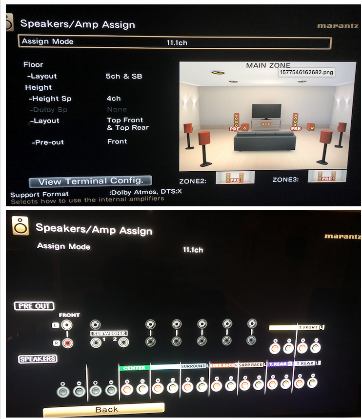

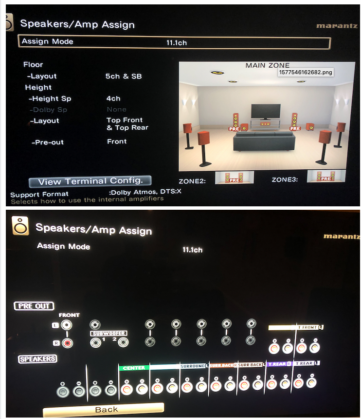

This is what I had earlier - picked up from one of my earlier posts , on my Marantz SR7010 Amp Assign/Speaker config:
In the above cases, the Front ch amps were reassigned to Height channels (Top/ceiling), as I needed them.., but you can just reassign to heights and not connect anything to the terminals, if theresnt a need.
I have , since then moved the Marantz upto my office room to support the 2 channel config, temporarily - so dont have this particular config anymore.

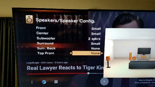

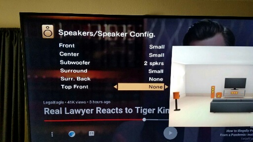

Because I don't know what I'm doing. My setup is 5.1.
I thought you has a 7 channel Monolith added, that's why I assumed you were running all 11 channels. For 5.1, you still need to select 7.1.4 first in order to assign FL and FR to pre out. After that, you can go back to the speaker menu and set the unused channel speakers (e.g. you said you set height to none..) to none. The FL/FR amps will remain disconnected to their pre outs that are connected to the external amp.
Oh no, I got the 7 channel Monolith because I'm neurotic, not because I needed them or anything!

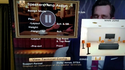

Okay, there was more to it than I thought so I went back in just now and I think I got it right this time because it solved my syrup problem... :p

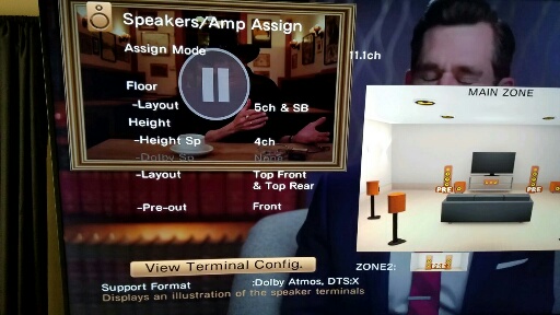

Exactly Kurt.., The way I understood is that this is done by decoupling via redirection ...
3 steps
Step 1) Configure AVR for 11 channels, [ eg 7.1.4 = 5 ch+ 2 Surround Back + 4 ch Height layer ]
Step 2) Preout the front channels to an external amp
Step 3) Redirect the front amps to something else (usually Heights) , using Amp Assign, by specifying 4 channels for Heights ( even if not actually using the heights..in which case you'd have a none for the top layer in speaker config)

Looks good... except...
Tiger King?
:eek::oops::rolleyes:
:p
Lawyer's reaction to it!
I knew someone was gonna comment on that, lol. Truthfully I have not watched it, but I have a friend who's pissed at me for not watching it yet because he wants to talk about it.
I do have a couple more sets of speakers and could go with a 11 channel setup if I find the motivation (and money) for it. I definitely have plenty of room and can have good placement for atmos. I'd get 2 pair of Prime elevations for my vaulted ceiling to use for atmos and my DefTech Promontor 1000s can easily be mounted for rear surround speakers.
8 hunnert bucks for 2 pair of Prime elevations is the only thing preventing me from doing it right now.

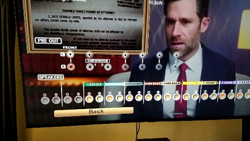

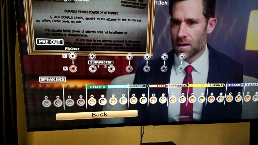

That is it, you can see that the amp assign menu now shows the front left/right amps assigned to two of the Heights, so if you connect a speaker to the front left or right speaker binding posts you won't get any sound in 2 channel Stereo mode.
The Front left/right Pre-outs are now connected to your external amps only.
