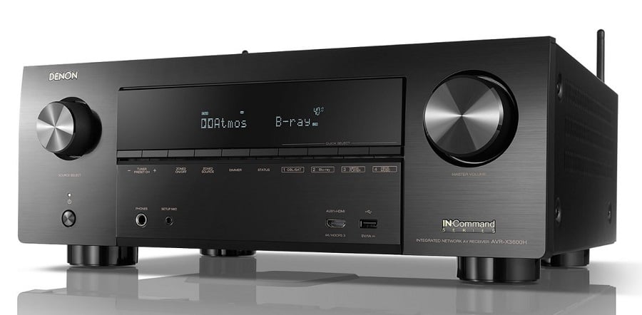

Thanks to Gene, who discovered a neat trick to use the AVR-X3600H with external amplifier(s) and disconnect the front left and right channel power amps to maximize the pre out performance for 2 channel stereo use.
ASR just measured it using this trick, and guess what, SINAD better than the AV8805 and AV7705. It beats the MRX-1120 too, just barely though.
I am curious to know how many will now feel comfortable using it as an AVP. It is 7.1.4 capable so aside from reliability, the RX-A2080 cannot touch it. I wish I know how to start a poll.
So users of the X4300H, SR6011, SR7010 and higher models should do the same if they want the pre out to perform better at 2 V and above, though I doubt the benefits are audible to too many people.
