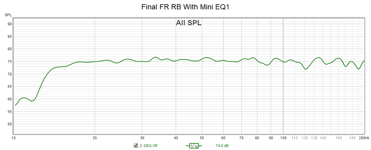

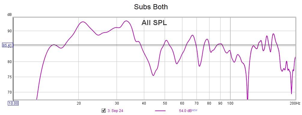

For instance I would say this first chart is closer to flat than the second chart, but it's not as linear. The second chart is not as flat, but is more linear or has less variance from start to finish.
I would call this one both flat AND very linear.

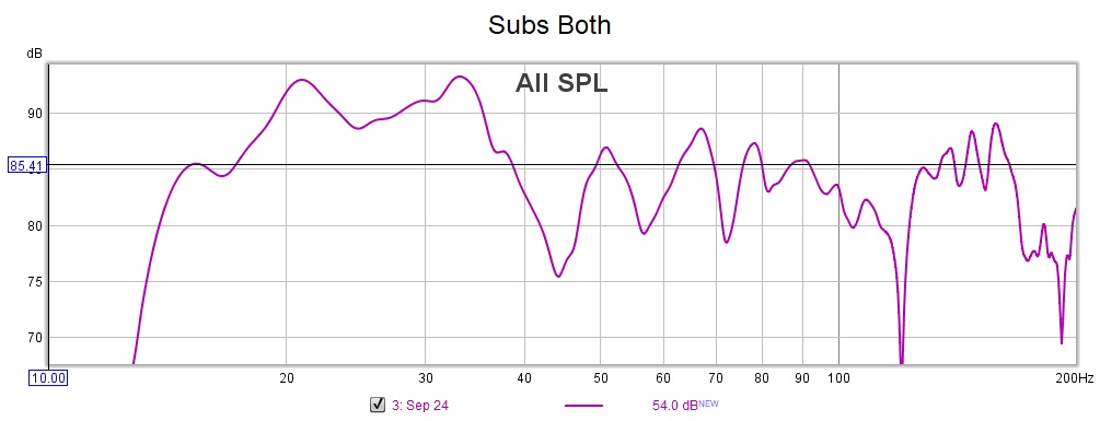

If you can't hear the difference between this,

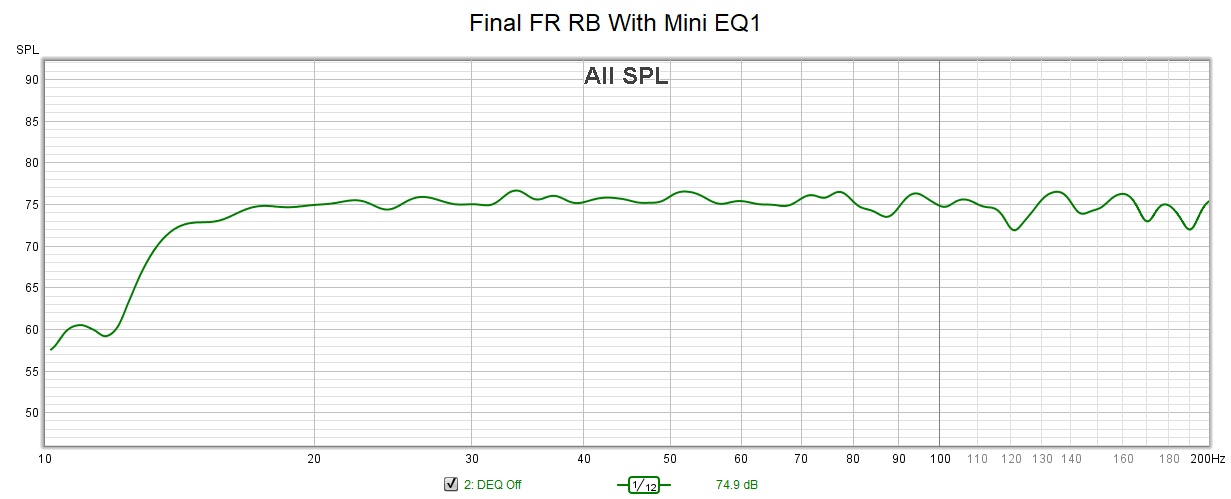

And this...
Then you're on the wrong forums! :p
So just curious, which one of these would you guess sounds better?
