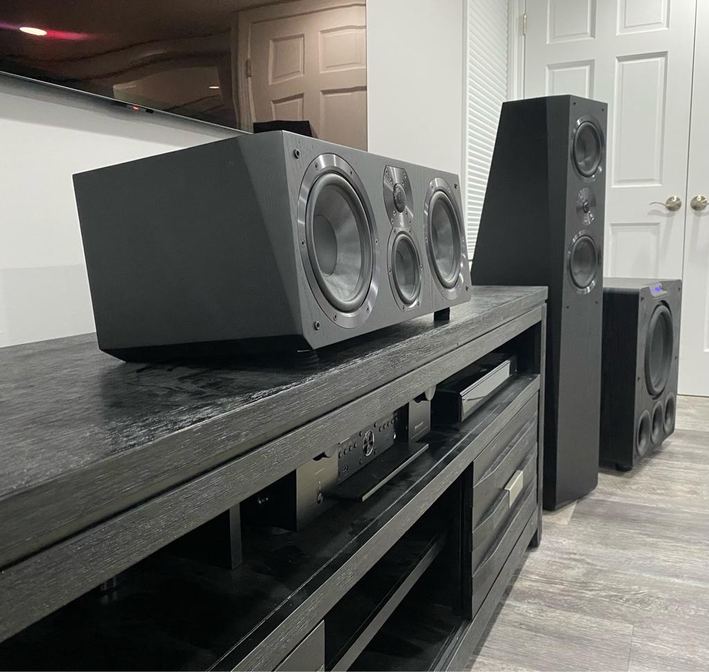

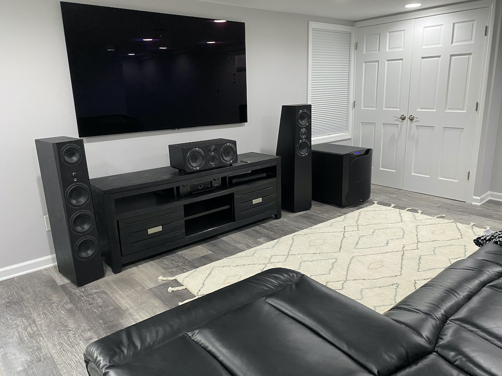

Gotta pic of where you have your centre channel right now? If that's all you are bumping, it's not too unusual. Still sounds like a placement issue to me tho...

Here.

There could be other things going on in there... we can't see the whole room, but if you are backed up against a wall or just sitting in a null, for example, you won't be able to boost your way out of it.

Maybe this will help?
I propped up the front end of the center
That was one of my suggestions, yes. It might help.
