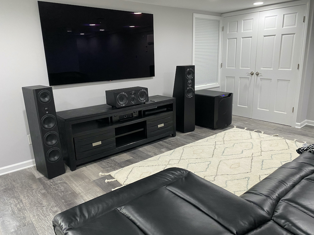

Been trying to stay away from this summation, but:
Consider:
Room size is relatively small.
SVS Towers (now) and PB4000 Subs.
Unwilling to experiment with placement.
Little to no room treatment.
DV on helps kill the bass and limits dynamic impact.
Center speaker is set +4dB above 0-trim. (While we do not know the rest of the trim settings.)
:rolleyes:
Consider:
:rolleyes:
Are you rolling your eyes at me????, shame on you - I haven't touched any other trims - only CC, but now +2 only
I have no other place to move speakers, sorry, I have the room I was given
Cheers and smile!
